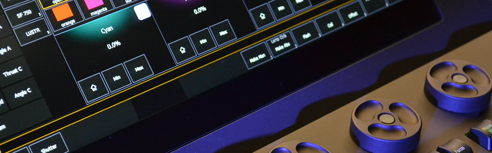

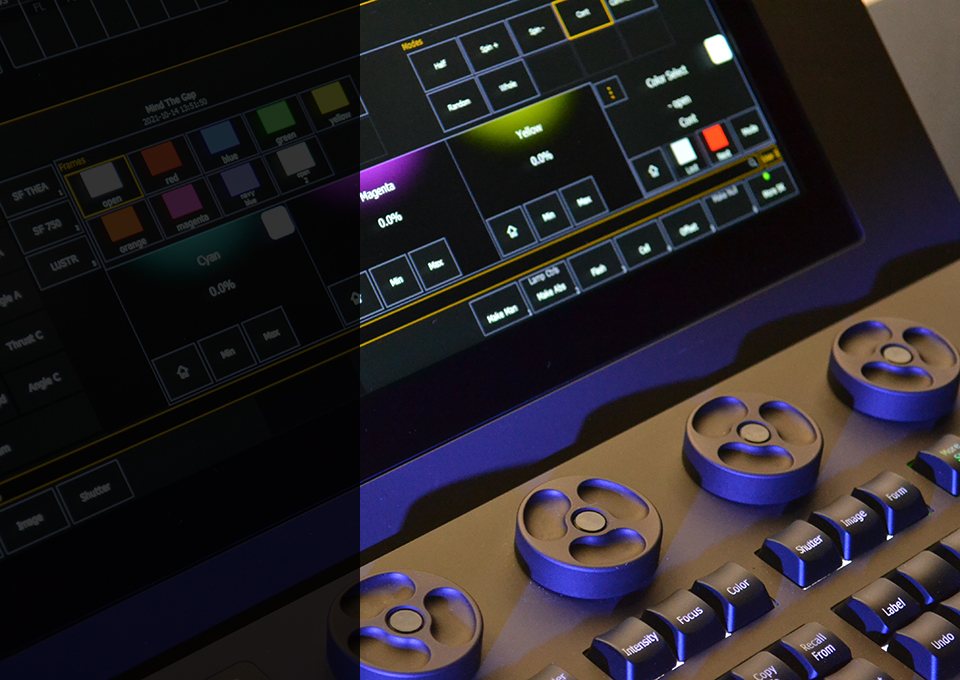

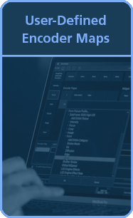

        User-Defined Encoder Maps
        User-defined Encoder Maps allow you to create custom layouts for all your fixture types. Once you’ve set them up, Eos automatically provides you with the correct maps based on your channel selection. Got more than one fixture type selected? No
            problem! Eos stacks your maps and provides you with filters to get to the control you need quickly. Want to get back to standard Eos encoder mapping? Popping between the two modes is a button-press away.
        Encoder Maps have a dedicated and intuitive editor. And, since they are a creatable target, they can be imported between show files – meaning you’ll never be without your layouts, no matter which gig you’re on.
            Encoder Map Quick Guide

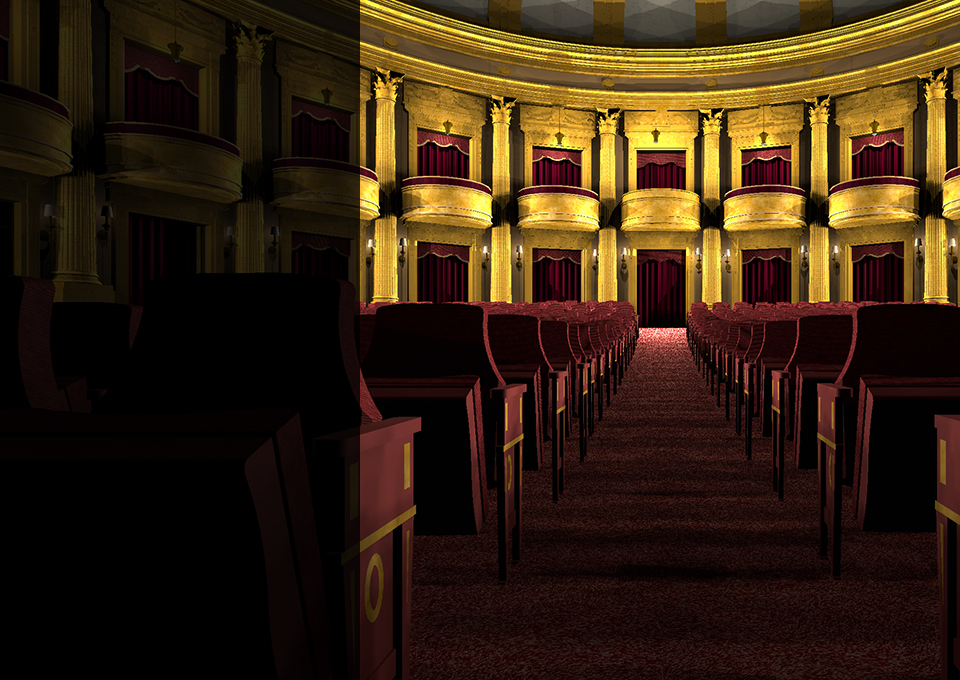

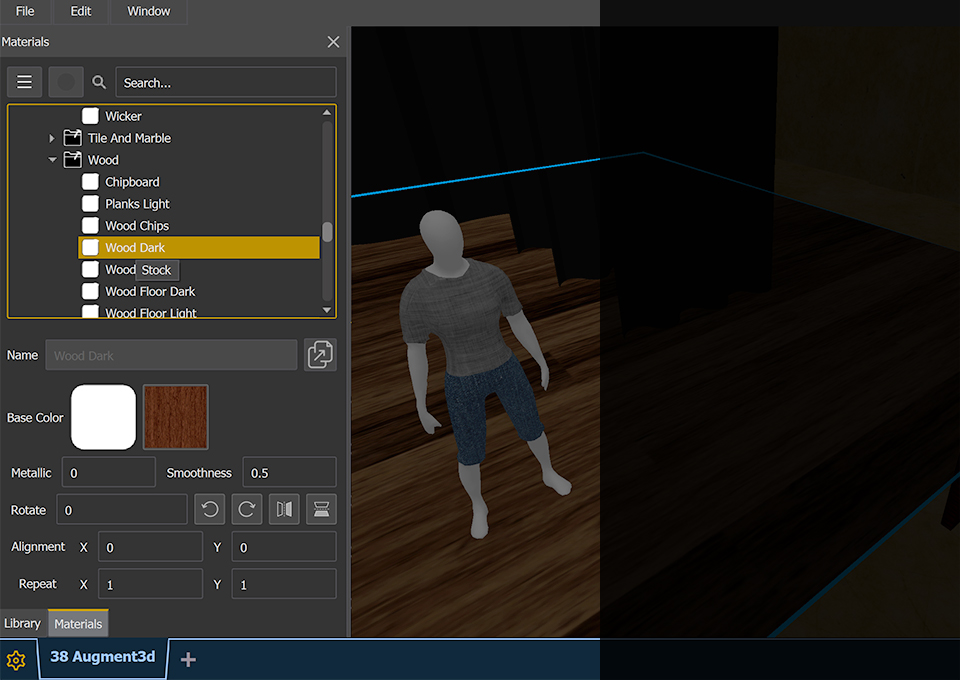

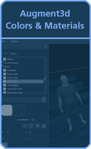

        Augment3d Colors & Materials

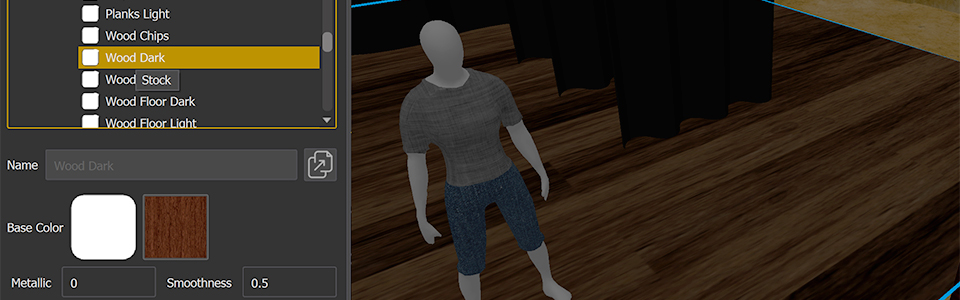

        Get that Augment3d model looking more like your scenery or venue! Eos v3.1 software introduces colors and materials to objects in Augment3d, bringing your 3D programming even closer to reality. Objects can be clad in textures (flat images) or
            materials (images & relief), which can be applied to model surfaces.
        Eos includes stock sets of materials, right in Augment3d. Need more textures that you know will work within Eos? Check out the new Materials library, free to download and fully supported.
            Materials Library →

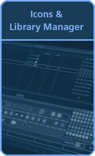

        Icons & Library Manager

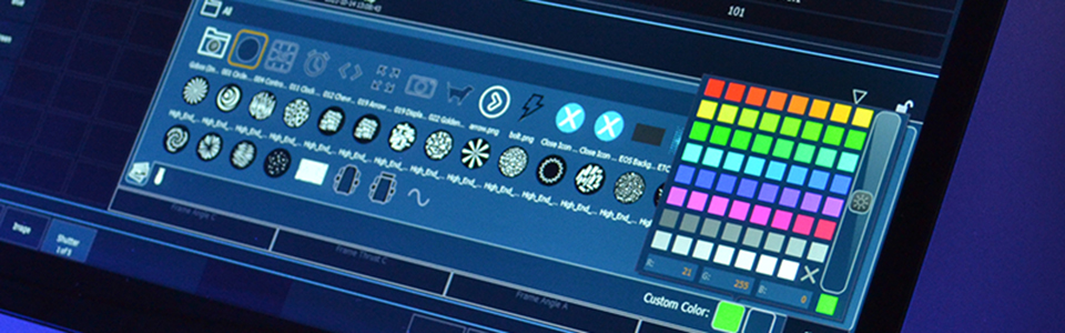

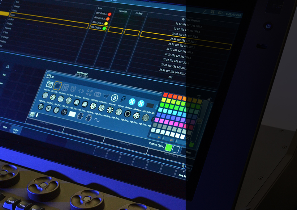

        Sometimes, labels aren’t enough. Now, you can add icons to Groups, Palettes, Presets, Macros, Effects, Magic Sheets, and Custom Direct Selects. When the target is displayed in a Direct Select, Eos shows you the icon in your choice of position.
        Want those icons on your magic sheets? You can now set “icon” as a field on supported targets.
        We’ve also improved the image management experience for Icons and Magic Sheets. You can now create folders, replace images in your library, and choose from an included array of stock icons. Want more? Check out our expansion icon libraries, downloadable
            for free.
            Icon Library →

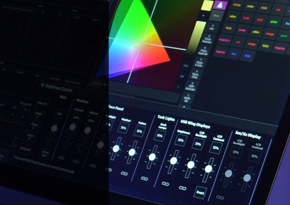

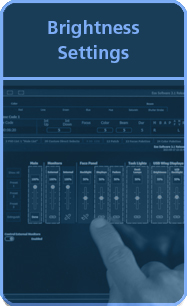

        Brightness Settings

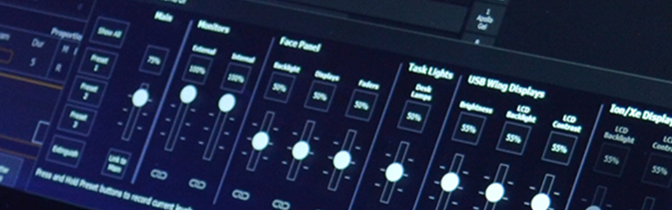

        Your work environment can be dynamic, and your console lighting should keep up. Now you can instantly access the brightness of your desk components from anywhere in the system. Pressing and holding [Displays] pops up the Brightness dialog, where
            console work lights and backlighting are immediately at your fingertips.
        Want to choose from a few different setups? Brightness Presets can now store and recall preferred levels across your hardware. But sometimes you need to focus on that detailed moment on stage without the console distracting your eye. Activating
            the Extinguish mode will temporarily turn off all lit surfaces, including external monitors.*
        Is your console in view during a performance? Brightness Presets and Extinguish mode can be called from a Macro, so you can trigger them on a Direct Select, when a cue fires, or even with timecode.
        *Requires monitors supporting Display Data Channel / Command Interface (DDC/CI)

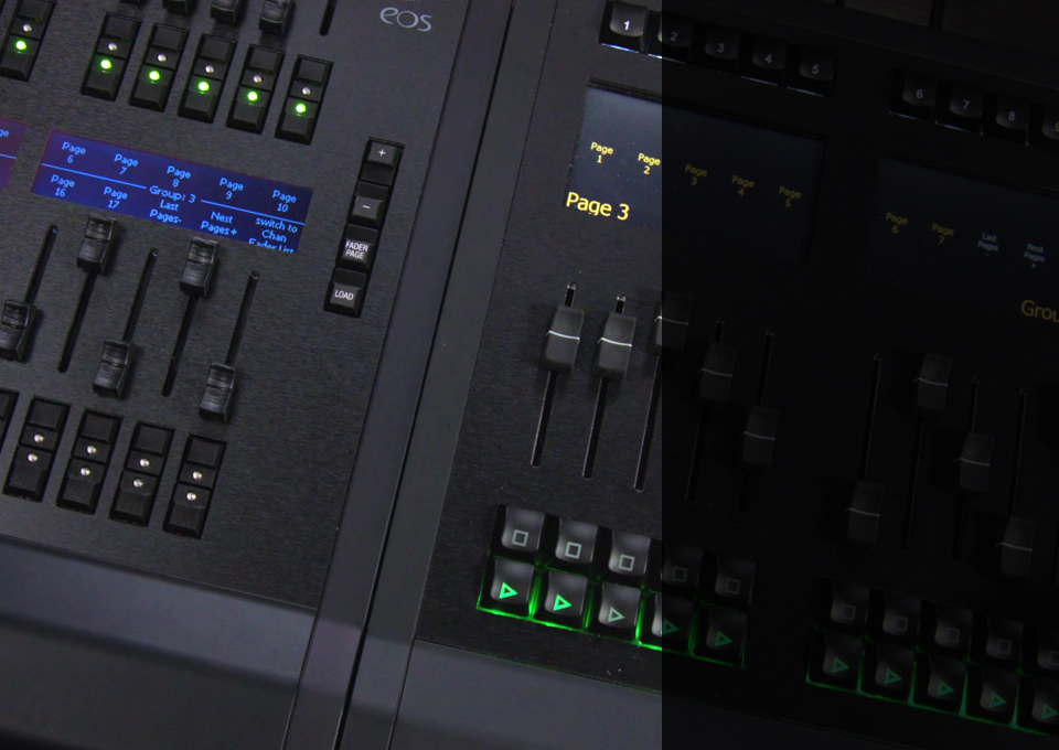

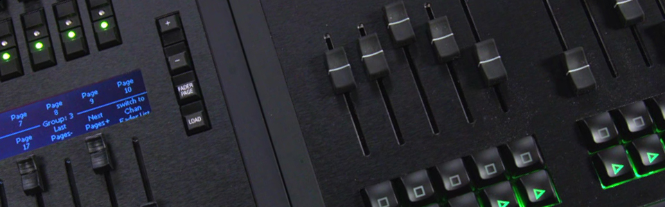

        Fader Wing Groups
        Some shows require a lot of handles. With Fader Wing Groups, you can now manage them more easily. Add multiple fader wings into a group, and they will page together as one, beautiful bank. Or set each wing in its own group so that you can page
            one wing without bothering the others.

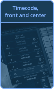

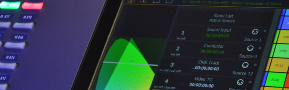

        Timecode, front and center

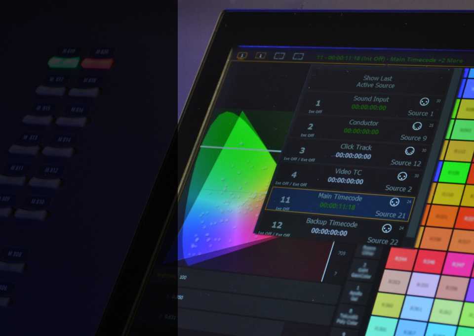

        Timecode is show-critical. You need to know what time is on the system, and when your cues will go. The timecode clock in the top-bar of each display is now a drop-down, allowing you to follow the most recently active timecode source, or to choose
            one to watch indefinitely. And cue lists now have a dedicated timecode column, so you can track when your events will trigger.

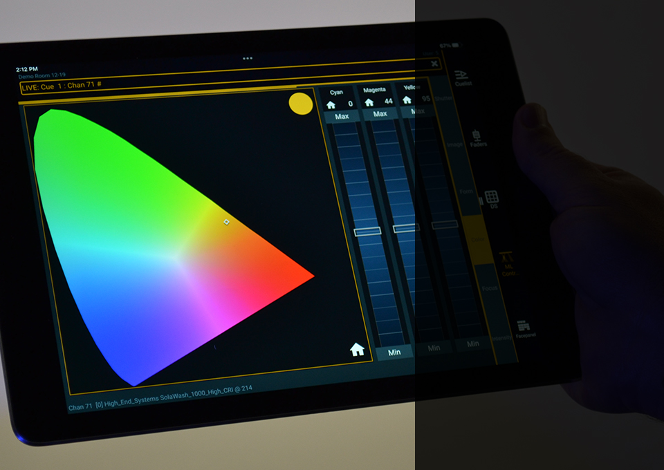

        RFR App
        We like to keep our apps fresh, too. The
            Eos RFR Mobile App got some bug-squashing, along with some minor improvements.
            - The ML Controls have more accessible scrolling functions and improvements for tablets in landscape mode.
            - Consoles with “Wifi Remote” disabled will no longer appear in the Connections screen on RFR.
            - There were some cleanups with OS permissions and Focus Wand.

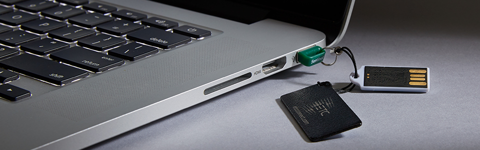

        ETCnomad
        Why should consoles have all the fun? We know you like to use Eos on your computer, too. In addition to all the features and improvements in Eos v3.1, we’ve added a few ETCnomad-specific changes to help you out.
            - Eos will show you all the NICs available on your machine, with configuration settings for each one.
            - Monitors just keep getting better. Eos ETCnomad now looks great on high DPI displays.
            - Sometimes you need all the space you can get. When programming on Mac or PC, you can now hide the encoder ribbon.
            Explore ETCnomad →
