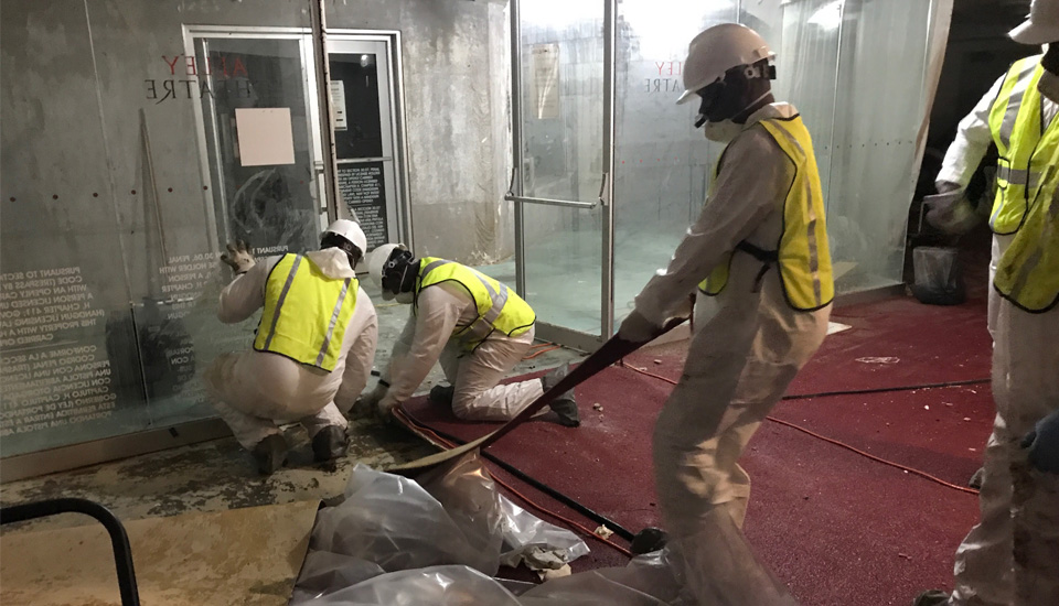

photo: Cleanup at the Alley Theatre

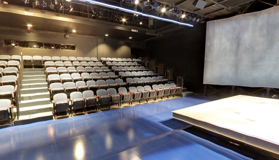

photo: The Neuhaus Theatre before Hurricane Harvey

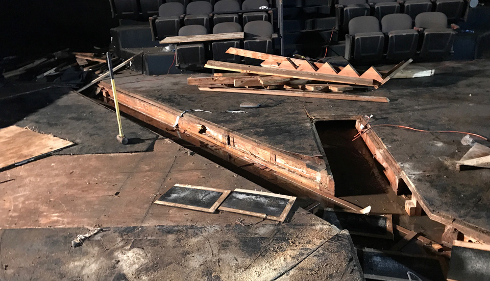

photo: The Neuhaus Theatre after Hurricane Harvey
