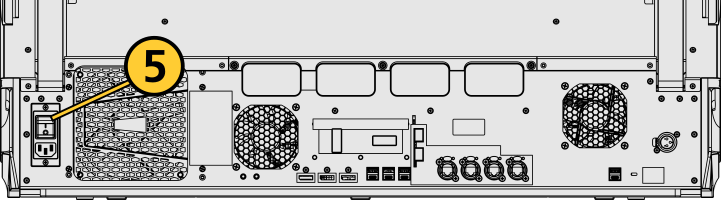

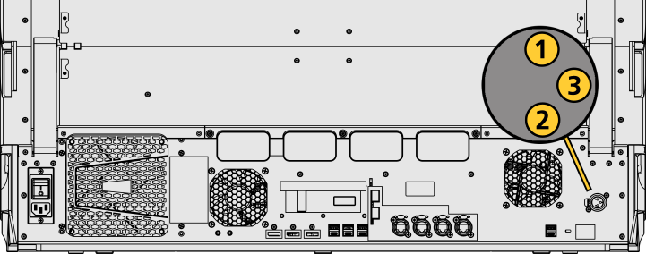

  1. Insert the included power cord, locking it into the IEC socket under the hard power switch on the back of the Ion Xe. Connect the other end of the cord to wall power.

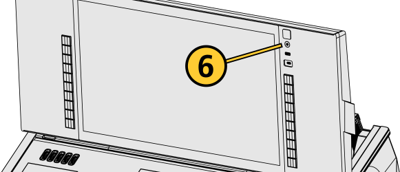

  6. Activate the soft power button on the front or top of the Ion Xe.

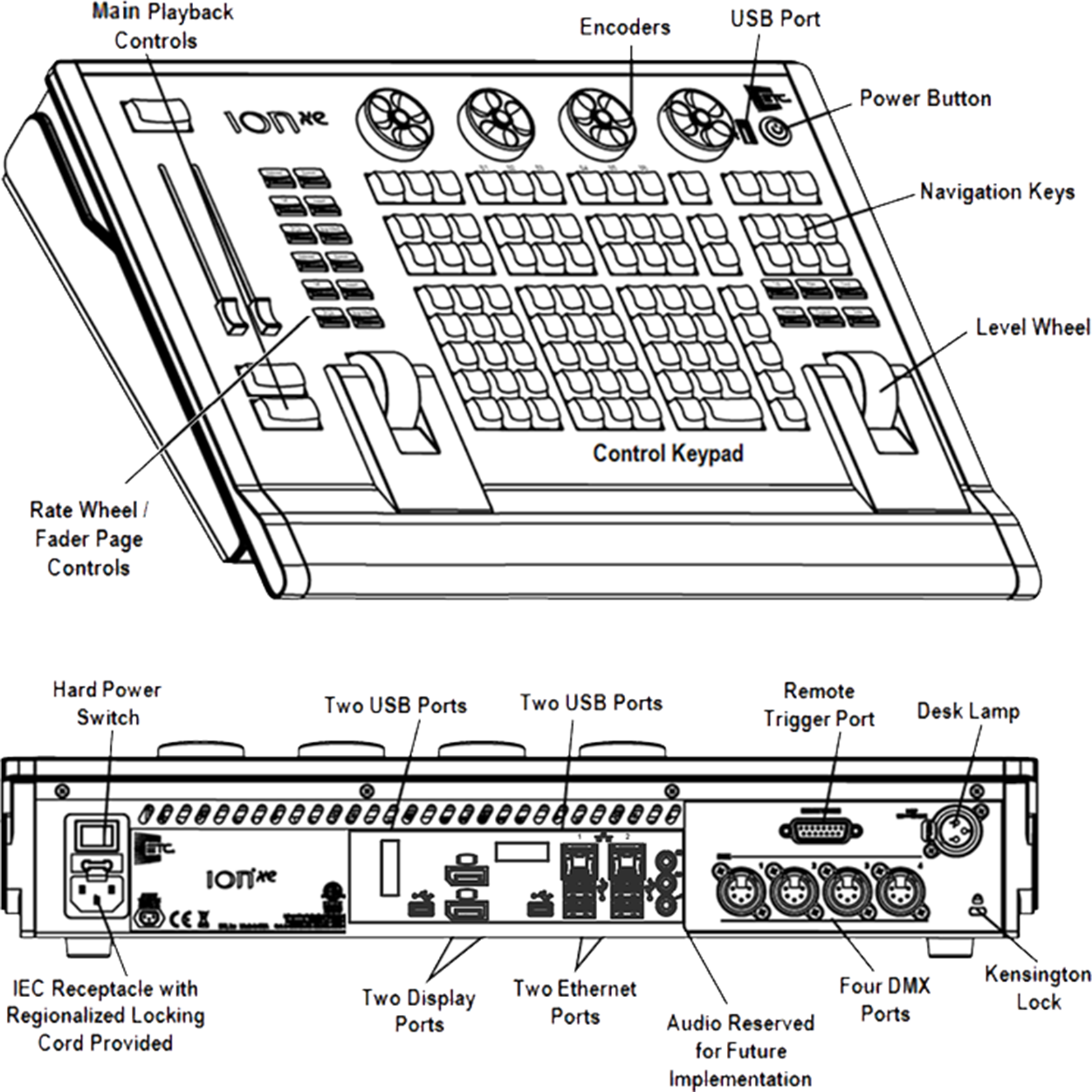

Physical Overview
Power
Power Button
The soft power button on the front of the Ion Xe is used to power it up or down.
Hard Power Switch
Fuse
A fuse is included for additional protection. Fuse ratings can be found on the rear panel of your console.

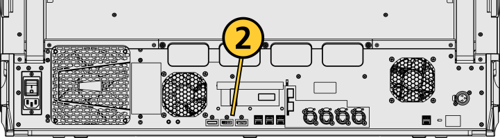

External Monitors
Gio @ 5, Ion Xe, and Element 2 consoles support up to two external Display Port monitors compatible with Windows 7 or later.
CAUTION: Devices without internal monitors that run Eos software (Ion Xe, Ion Xe 20, Element 2, ETC Puck, Ion Classic, and Element Classic) must have at least one external monitor connected for the Eos application to initialize.

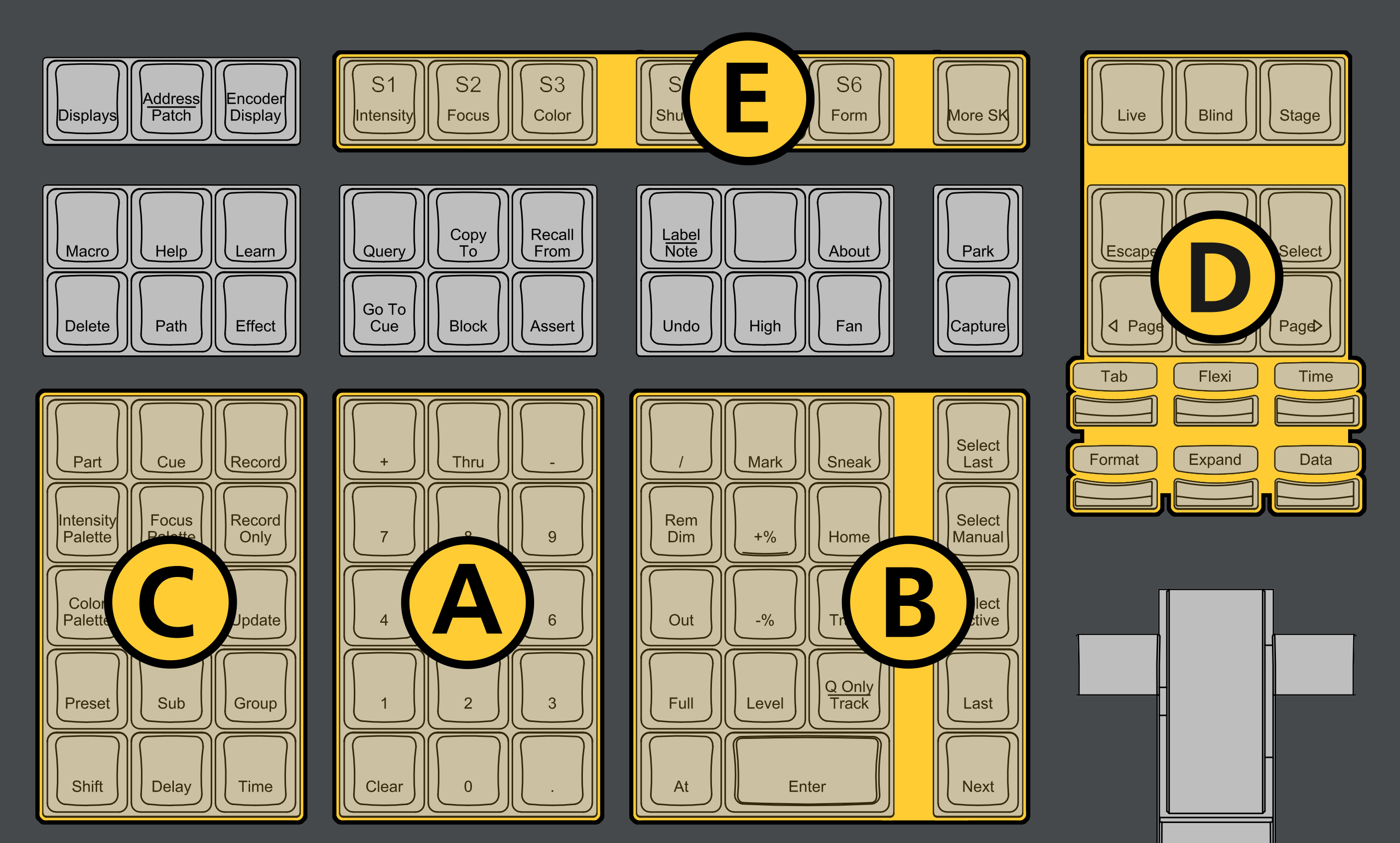

Hardkeys
E Encoder Categories The encoder category buttons allow expanded control of a variety of fixture parameters, along with additional softkey options where applicable.

Encoders and an associated LCD for control of non-intensity parameters are provided at the top center of the console. The four encoders are pageable controls, which are populated on the LCD with the parameters used in your show.
Level Wheel
Rate Wheel
The rate wheel can be used to provide dynamic rate adjustments for multiple playbacks.

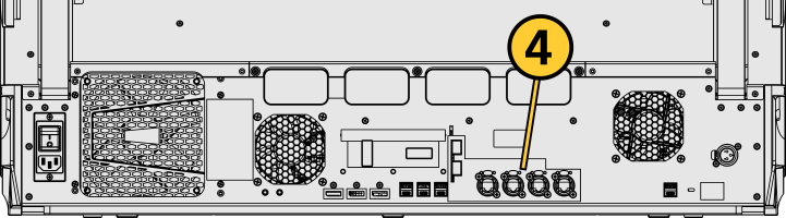

DMX Ports
In order to output control levels from your console, you can use the DMX ports on the back of the console and/or you may connect a gateway or node. If your device receives sACN or Art-Net directly, no gateway or node is required.
To output, connect one 5 pin XLR cable per port. The first port will default to outputting the first universe of DMX, addresses 1-512, the second port to the second universe, outputting addresses 513-1024, and so on.

Ethernet Ports
USB Ports
One USB port is provided on the front of the console to connect any USB storage device. Additional USB ports on the rear panel (and in the keyboard tray, when present) of the console connect peripherals such as an alphanumeric keyboard, pointing device, or touchscreen control for external monitors.

Pin 2 0 VDC.
Pin 3 +12 VDC.

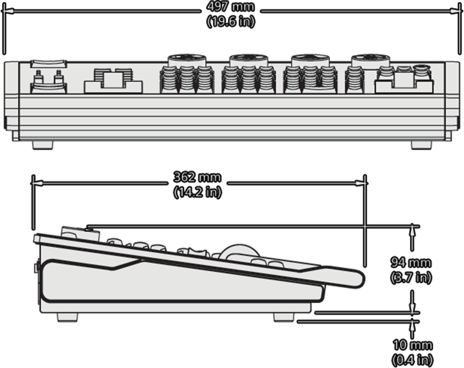

Dimensions and Weights
mm in mm in mm in kg lb
Ion Xe 295 11.61 774.7 30.5 589.28 23.2 20.5 45
Ion Xe in shipping container 876.3 34.5 692.2 27.3 257.2 10.1 27.2 60
Ion Xe in travel case 863.6 34 919.5 36.2 234.2 9.3 36.3 80
