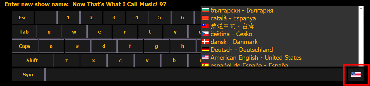

Keyboard
Allows you to select the language for the alphanumeric keyboard within Eos. A wide variety of keyboards are supported.
The keyboard can also be changed in the application when the virtual keyboard is open. Click on the flag icon to see a language drop-down menu.
Press {Sym} to switch the keyboard from alphanumeric to symbols. When in symbol mode, press {Abc} to return to the alphanumeric keyboard.

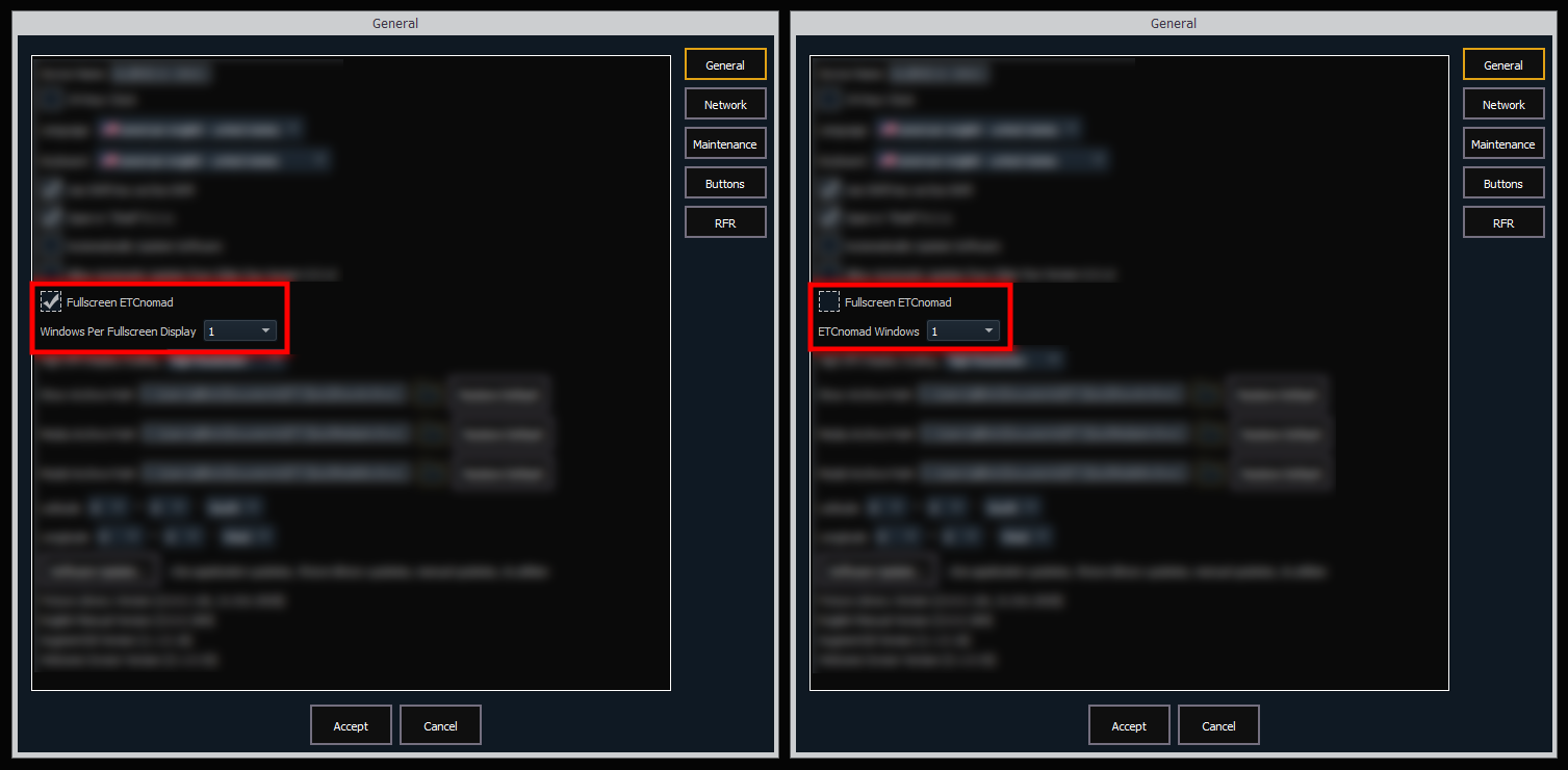

Fullscreen ETCnomad
Note: This option is only available on ETCnomad.
When enabled, ETCnomad will automatically launch fullscreen, on all connected monitors of your computer. Select "1" in the "Windows Per Fullscreen Display" dropdown to show a single fullscreen ETCnomad display on each monitor, or "2" to subdivide each fullscreen display into 2 ETCnomad windows.
When disabled, ETCnomad will launch in a standard windowed display. The "ETCnomad Windows" dropdown allows you to choose to open up to 6 separate windows.

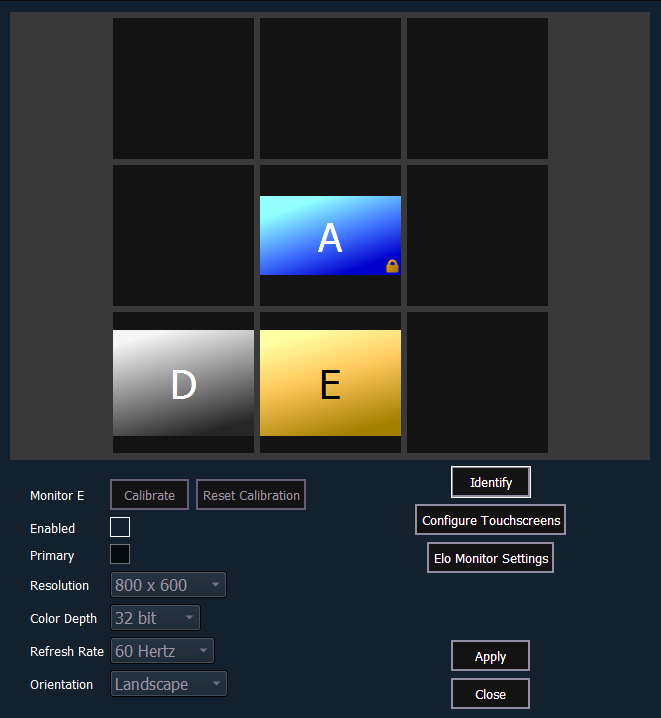

{Monitor Arrangement...}
The monitor arrangement tool will dictate how and where the pointer moves from one monitor to another. Generally speaking, you will want the logical placement on this screen to match your physical placement.
The selected monitor will display in yellow. External monitors can be dragged to any of the surrounding black boxes to mimic actual monitor layout. Internal monitors are locked in relationship to each other and have read-only settings that cannot be changed.
The following buttons are available in the monitor arrangement display:
  • {Calibrate} - calibrates the selected touchscreen.
  • {Reset Calibration} - restores default calibration data for selected display.
  • {Identify} - displays the video ports that your monitors are connected to on the physical monitors to confirm where you have placed them.
  • {Enabled} - When checked, the monitor is available for use. The console will display the {Enabled} box checked for any monitors it recognizes.
  • {Primary} - selects which monitor will display the Eos Configuration Utility and Central Information Area (CIA). On consoles with internal monitors, the primary is locked to the right touchscreen on the console.
  • {Resolution} - sets how many pixels the monitor will display.
  • {Color Depth} - sets how many colors will be displayed.
  • {Refresh Rate} - sets the number of times in a second the monitor refreshes.
  • {Orientation} - sets the monitor layout.
  • {Apply} - will save and use your settings. A window will open asking if you want to {Keep Changes} or {Revert} back to the defaults. {Revert} will be selected after 15 seconds if nothing else has been selected first.
  • {Close} - will close the display. {Close} will not save any settings if {Apply} has not been used.
  • {Configure Touchscreens} - is used to map the touchscreens to the displays.
  • {Elo Monitor Settings} - opens the properties window for the monitor. See {Calibrate Elo External Touch Screen}.
  • {ETC Monitor Settings} - opens the properties window for the monitor.
Monitor options may vary, and only supported options will display. The minimum recommended resolution is 1920x1080, although it is possible to assign lower resolutions.

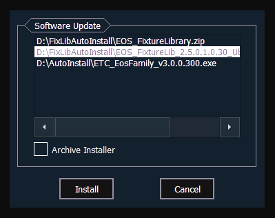

{Software Update}
Allows the installation of Eos Family software and other ETC-approved software (Concert, UpdaterAtor, GCE, and NCE). Updating Eos Family software does not affect or update the software in any other networked device such as a Net3 Gateway.
When you select {Software Update...}, the console looks at the root directory of any connected USB storage device for an Eos Family console software update file. You will be shown the names of any updater files found on the drive. Select the file you would like to install and click the {Install} button, or click {Cancel}. The software will first save to the hard drive before opening the installer.
You will also receive a message if no software update file can be found.
{Software Update...} also recognizes zipped fixture library files provided by ETC.
  1. Select the desired ZIP file from the Software Update window.
  2. You will be asked to confirm that you want to install the selected file. Click {Yes} to continue or click {No} or {Cancel} to return to the Software Update window.
  3. A window will open showing the progress of extracting the ZIP file. The installer will then launch after the file has been extracted.
