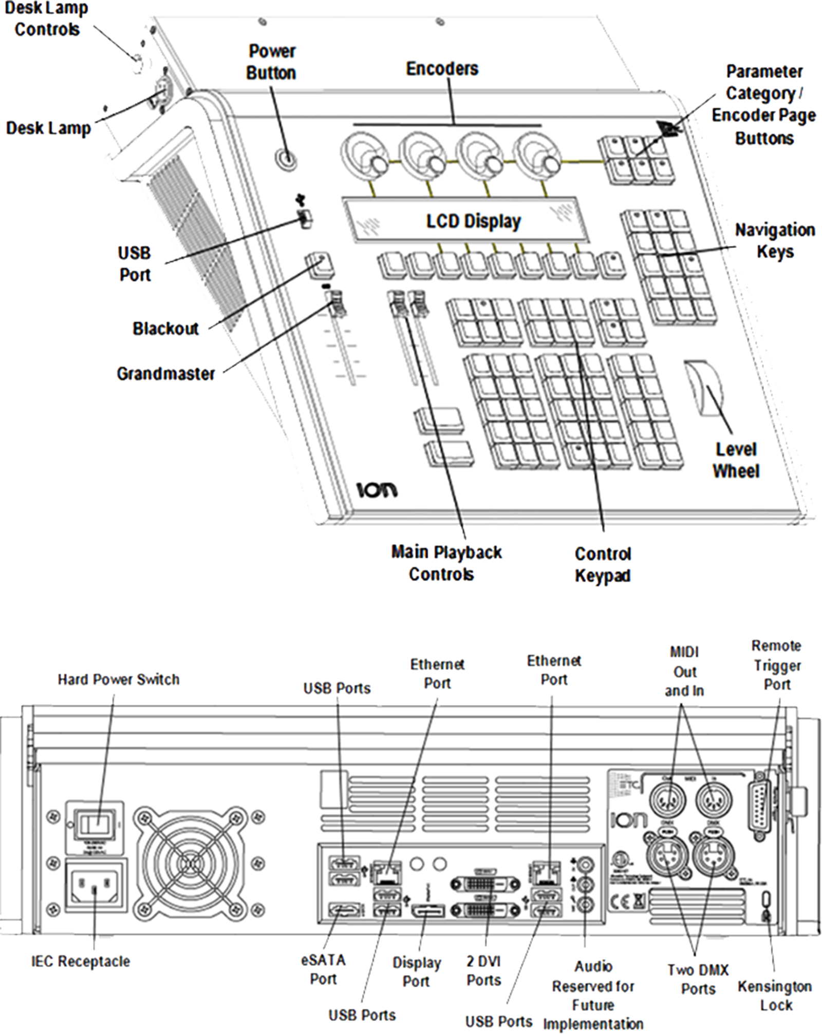

Physical Overview
Power
Power Button
The soft power button on the front of the Ion Classic is used to power it up or down.
Hard Power Switch
Battery
External Monitors
CAUTION: Devices without internal monitors that run Eos software (Ion Xe, Ion Xe 20, Element 2, ETC Puck, Ion Classic, and Element Classic) must have at least one external monitor connected for the Eos application to initialize.
Windows 7 Ion Classic can support up to 2 monitors: either 2 DVI monitors, or 1 Display Port and 1 DVI.
Display Port can use an active adapter to VGA, DVI, or HDMI. DVI-I can be converted to VGA with a passive adapter.
Output to 4K resolution monitors may affect console performance. ETC recommends an external monitor resolution of 1024 or lower for use with Ion Classic consoles.

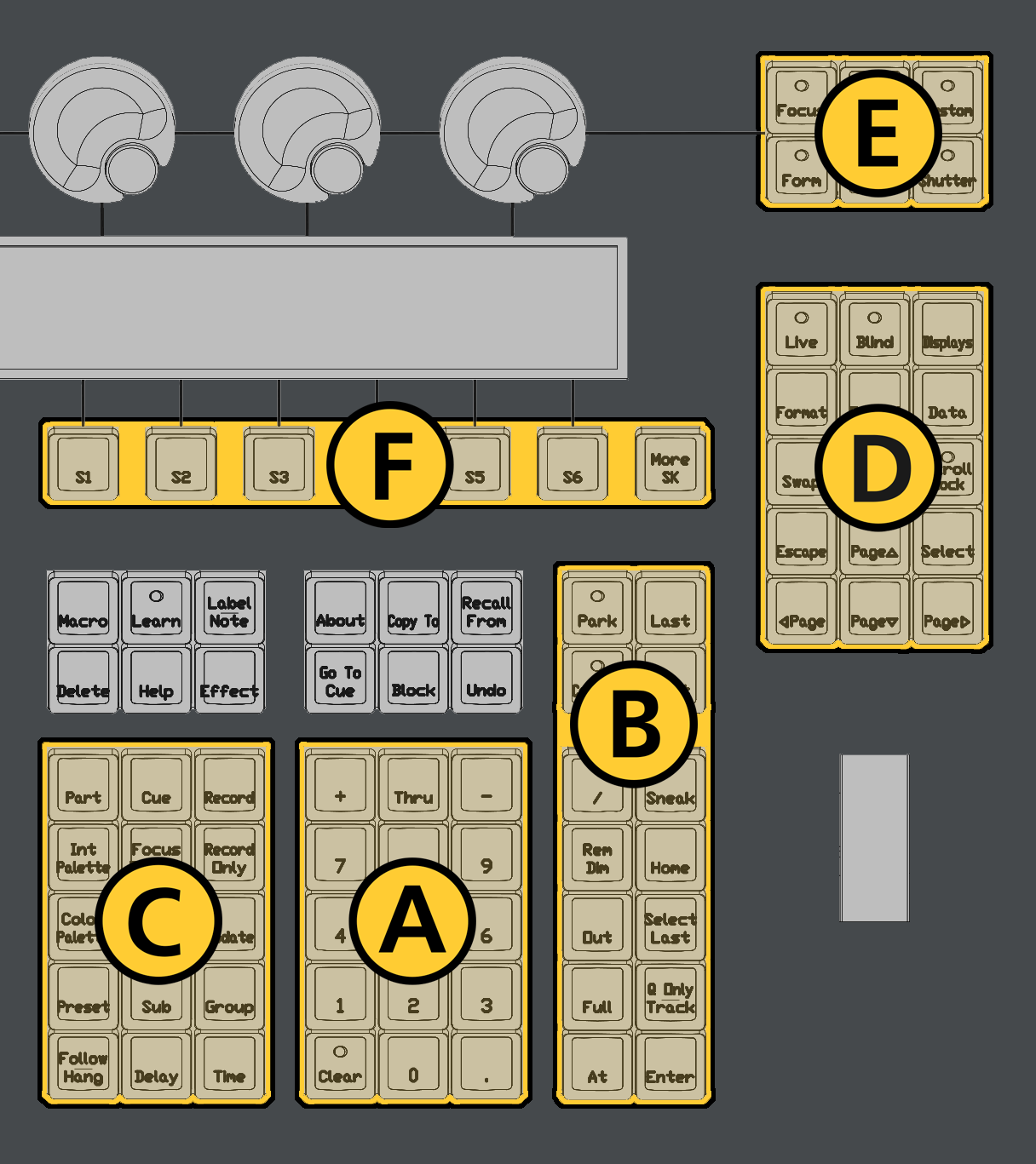

Hardkeys
E Encoder Categories The encoder category buttons allow expanded control of a variety of fixture parameters, along with additional softkey options where applicable.
F Softkeys Softkeys allow physical control of context-based software options that change in response to the active display or command line syntax, including the onscreen softkey options, offering additional commands not available on hardkeys.

Main Playbacks
Fader Buttons
Load buttons, located directly above each fader, are used when Assigning Faders to load a specified target to the associated fader, or to place special conditions on that fader.
Encoders
Encoders and an associated LCD for control of non-intensity parameters are provided at the top center of the console. The four encoders are pageable controls, which are populated on the LCD with the parameters used in your show.
LCD
This display accompanies the CIA as an additional user interface. This LCD offers you softkeys, encoder information, and an additional view of the command line. To adjust the brightness and contrast levels of the LCD, go to Setup > Device > Brightness Settings and Presets > Ion Display.
Level Wheel
DMX Ports
In order to output control levels from your console, you can use the DMX ports on the back of the console and/or you may connect a gateway or node. If your device receives sACN or Art-Net directly, no gateway or node is required.
To output, connect one 5 pin XLR cable per port. The first port will default to outputting the first universe of DMX, addresses 1-512, the second port to the second universe, outputting addresses 513-1024, and so on.
See Local Output for information on reconfiguring the DMX ports.
Ethernet Ports
USB Ports
One USB port is provided on the front of the console to connect any USB storage device. Additional USB ports on the rear panel (and in the keyboard tray, when present) of the console connect peripherals such as an alphanumeric keyboard, pointing device, or touchscreen control for external monitors.

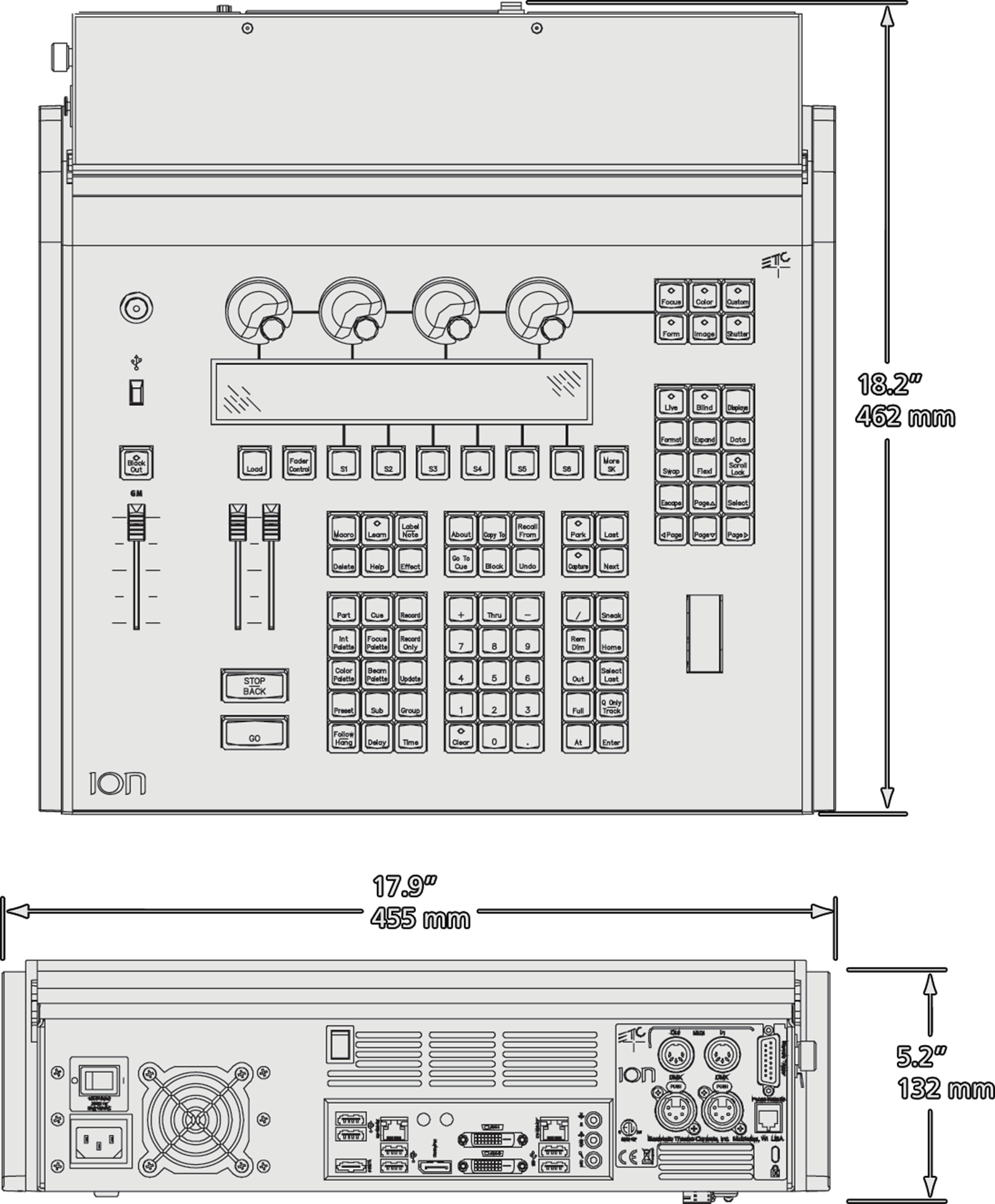

Dimensions and Weights
mm in mm in mm in kg lb
Ion Classic 132 5.2 455 17.9 462 18.2 9.23 20.35
