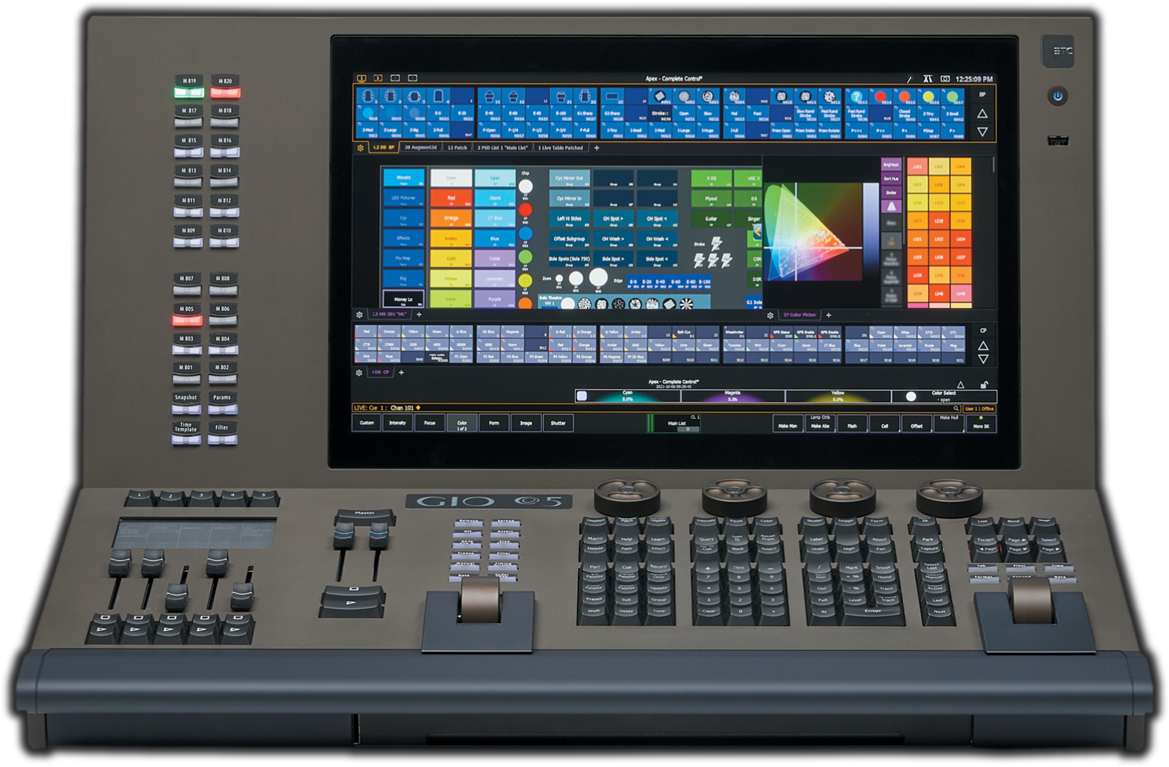

Gio @5
Gio @5 brings the high-end control of the larger Eos Family consoles to venues with tighter spaces. This portable console packs all the control necessities into a compact footprint, so external monitors and accessories are optional.

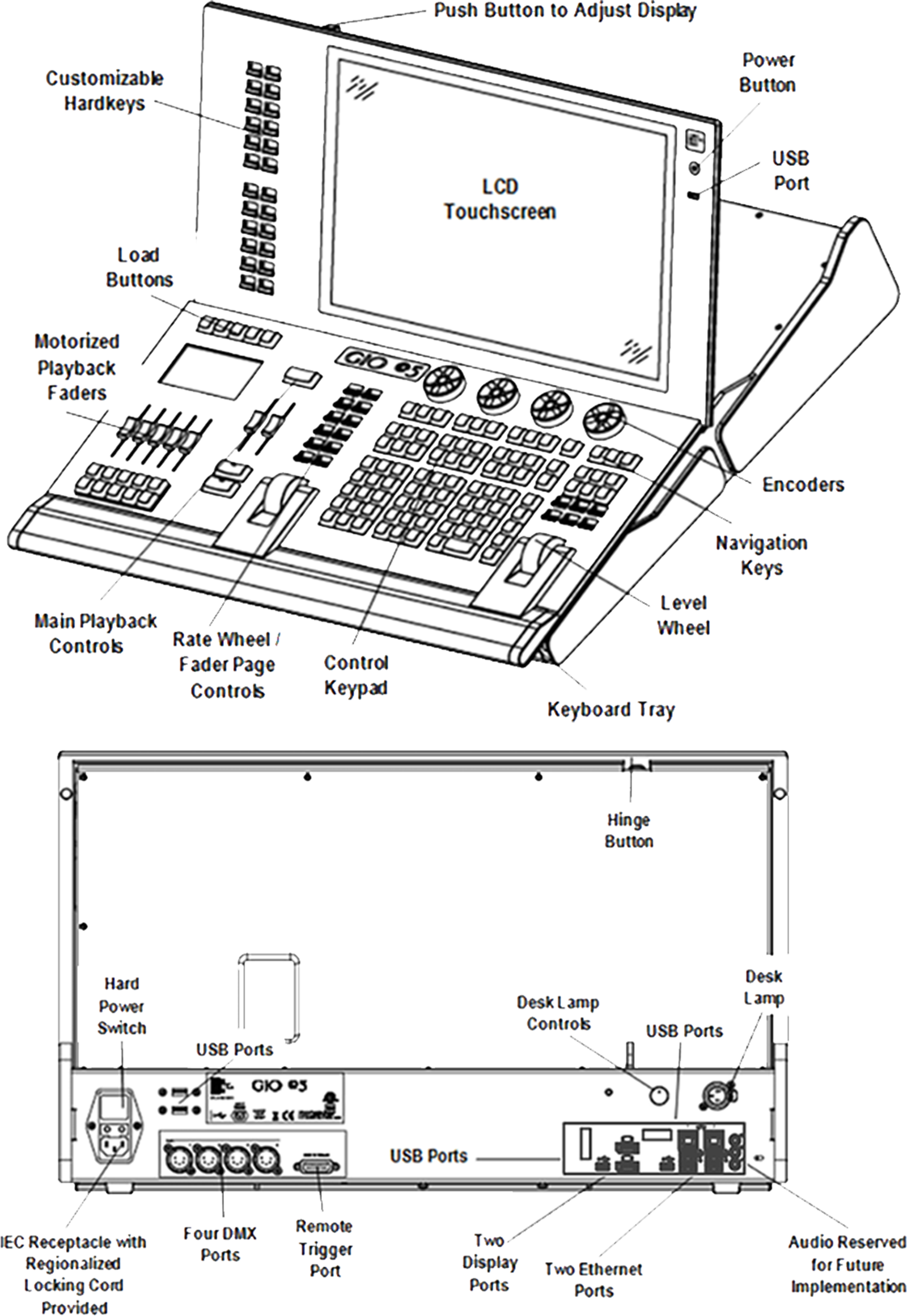

Physical Overview
Power
Power Button
The soft power button on the front of the Gio @5 is used to power it up or down.
Hard Power Switch
Fuse
A fuse is included for additional protection. Fuse ratings can be found on the rear panel of your console.
CAUTION: For continued protection against risk of fire, replace only with same type and rating of fuse.
VORSICHT: Um weiterhin gegen Brandrisiko geschützt zu sein, ersetzen Sie die Sicherung nur mit einer Sicherung gleichen Typs und den gleichen Nennwerten.
ATTENTION: Pour ne pas compromettre la protection contre les risques d’incendie, remplacer par un fusible de même type et de mêmes caractéristiques nominales.
Battery
Internal Touchscreens
Gio @ 5 is designed with a single internal touchscreen display. The touchscreen may be used to display and control show data. It can also be used as a variety of other virtual controls and displays.
The touchscreen angle can be adjusted by pushing the button in the left side top of the display and moving the panel up or down.
Touchscreen brightness can be controlled via Setup > Device > Brightness Settings and Presets.
External Monitors
Gio @ 5, Ion Xe, and Element 2 consoles support up to two external Display Port monitors compatible with Windows 7 or later.
Monitor Specifications for DVI Devices
  • Maximum digital resolution 2560x1600 (30Hz refresh rate) or 1920x1200 (60Hz refresh rate).
  • Maximum VGA resolution 2048x1536 (30Hz refresh rate) or 1920x1200 (60Hz refresh rate).
  • Output to 4K resolution monitors may affect performance.

Main Playbacks
Motorized Faders
In addition to the main playbacks, five slots of configurable motorized faders are provided. The faders may be configured as playbacks, submasters, grandmasters, timing masters, effects masters, targets, or target lists. One hundred virtual pages of 10 faders each are provided.
The fader bank has a dedicated LCD display for local status of playback content.
Fader Buttons
Load buttons, located directly above each fader, are used when Assigning Faders to load a specified target to the associated fader, or to place special conditions on that fader.
Encoders
Haptic-feedback encoders are provided above the control keypad. The four encoders are pageable controls, which are populated with the parameters used in your show. Current encoder mapping is indicated at all times, and the [Encoder Display] button opens full control on the screen.
Level Wheel
Rate Wheel
The rate wheel can be used to provide dynamic rate adjustments for multiple playbacks.
DMX Ports
In order to output control levels from your console, you can use the DMX ports on the back of the console and/or you may connect a gateway or node. If your device receives sACN or Art-Net directly, no gateway or node is required.
To output, connect one 5 pin XLR cable per port. The first port will default to outputting the first universe of DMX, addresses 1-512, the second port to the second universe, outputting addresses 513-1024, and so on.
See Local Output for information on reconfiguring the DMX ports.
Ethernet Ports
USB Ports
One USB port is provided on the front of the console to connect any USB storage device. Additional USB ports on the rear panel (and in the keyboard tray, when present) of the console connect peripherals such as an alphanumeric keyboard, pointing device, or touchscreen control for external monitors.
Task Lights
Littlites®
Pin 2 0 VDC.
Pin 3 +12 VDC.
Dimming Task Lights

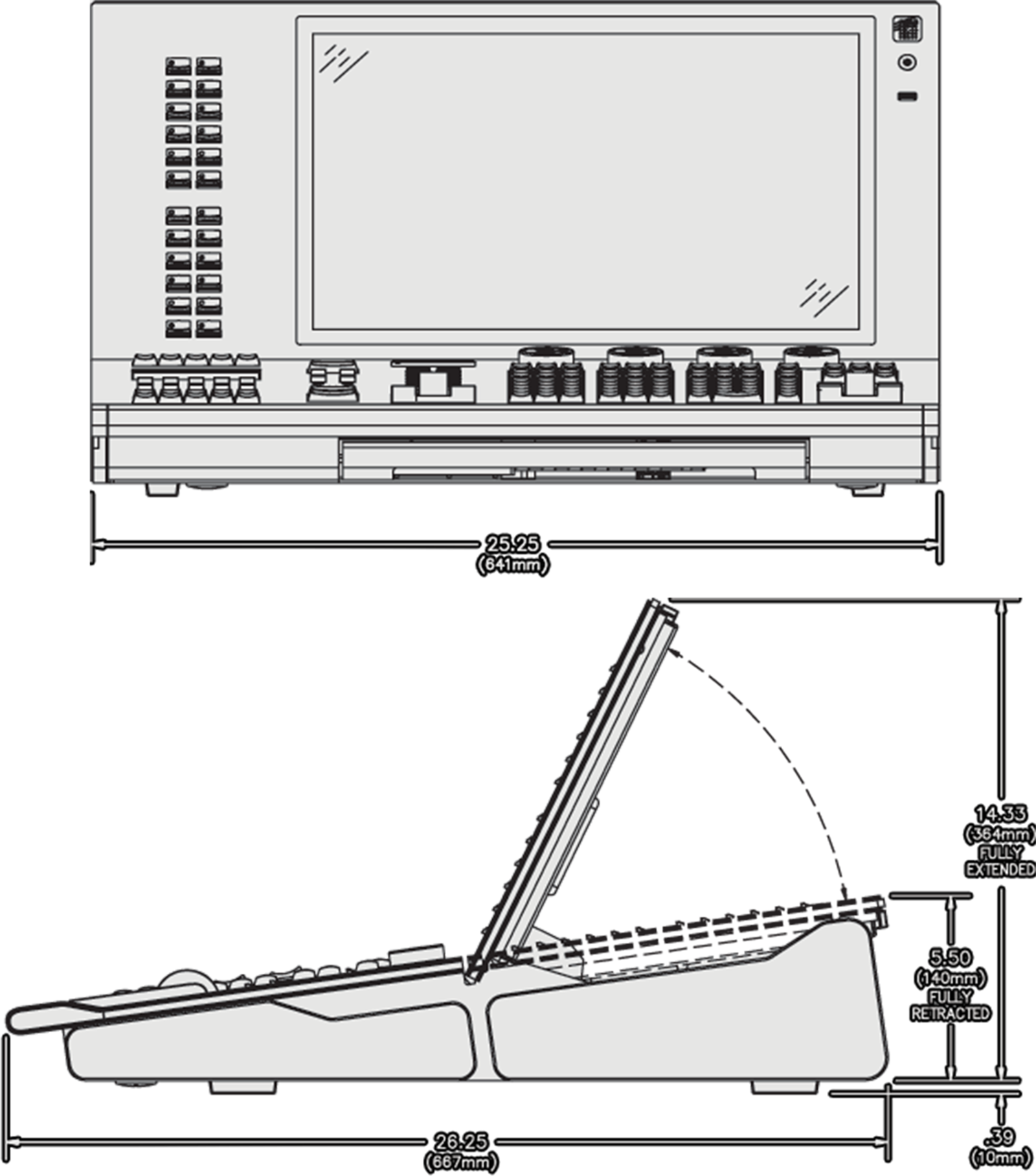

Dimensions and Weights
mm in mm in mm in kg lb
Gio @5 364 14.3 641 25.3 667 26.3 23.59 52.0
Gio @5 in shipping container 342 13.5 769 30.3 775 30.5 27.67 61.0
Gio @5 in travel case 292 11.5 781 30.8 813 32.0 42.52 93.8
