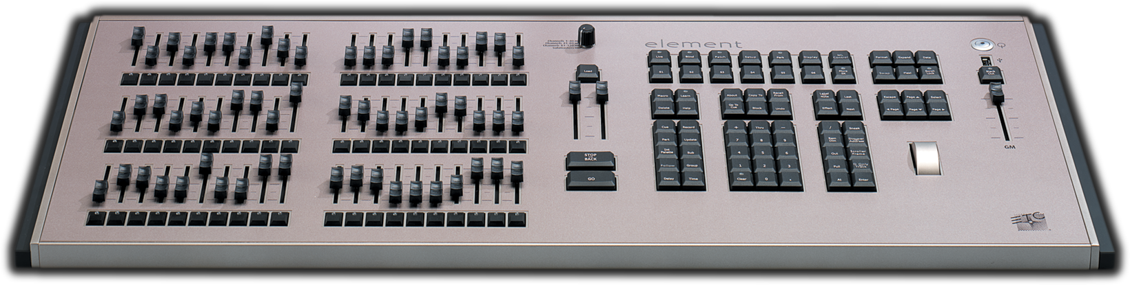

Element Classic
Legacy Hardware
Designed for venues using primarily conventional lighting, the Element Classic control console provides the powerful features of the Eos system in an economical and simplified package.

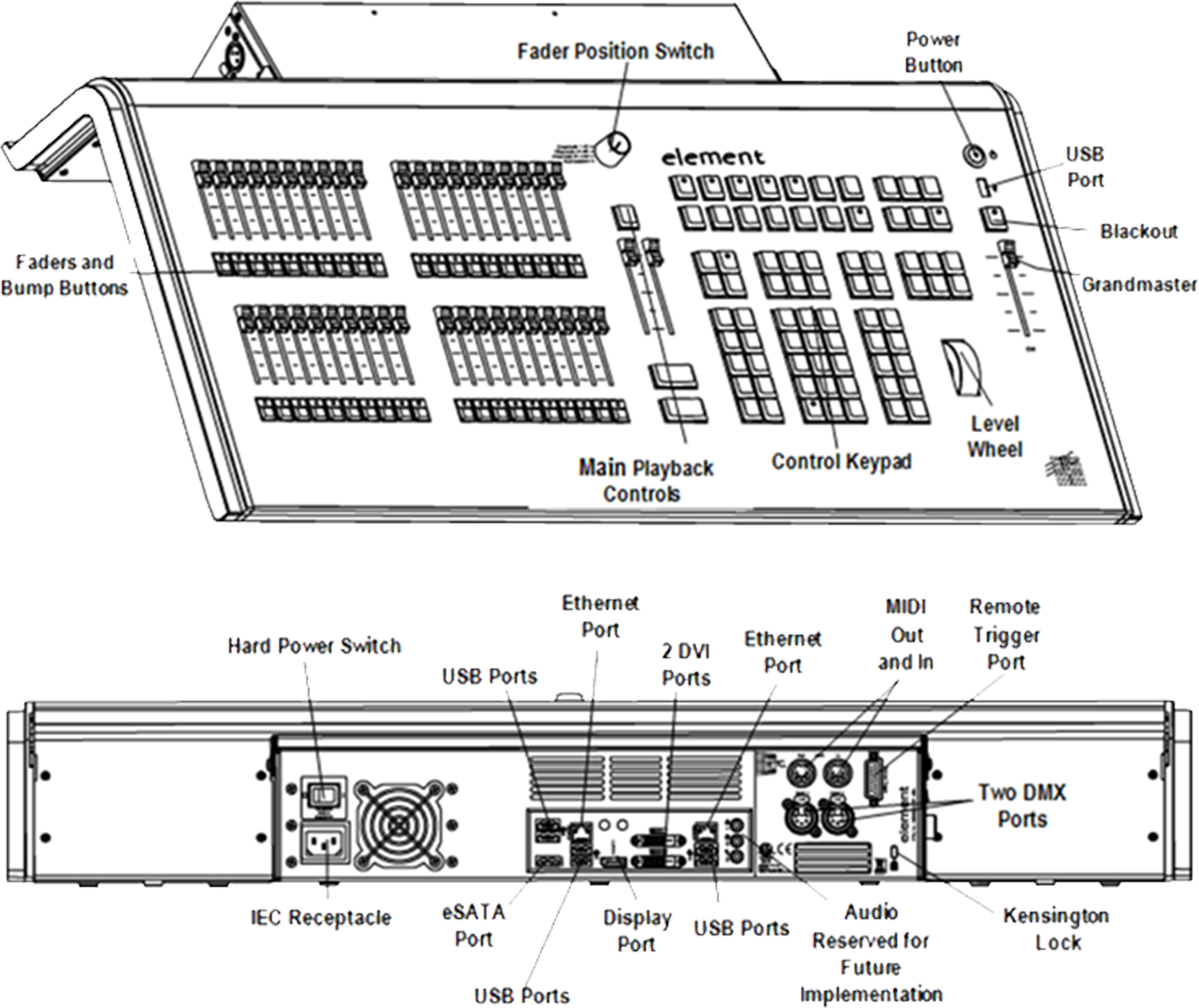

Physical Overview
Element Classic hardware layout.

Physical Overview
Power
Power Button
The soft power button on the front of the Element Classic is used to power it up or down.
Hard Power Switch
Battery
External Monitors
CAUTION: Devices without internal monitors that run Eos software (Ion Xe, Ion Xe 20, Element 2, ETC Puck, Ion Classic, and Element Classic) must have at least one external monitor connected for the Eos application to initialize.
Windows 7 Element Classic can support up to 2 Display Port, DVI-I, or DVI-D monitors.
Display Port can use an active adapter to VGA, DVI, or HDMI. DVI-I can be converted to VGA with a passive adapter.
Output to 4K resolution monitors may affect console performance. ETC recommends an external monitor resolution of 1024 or lower for use with Element Classic consoles.

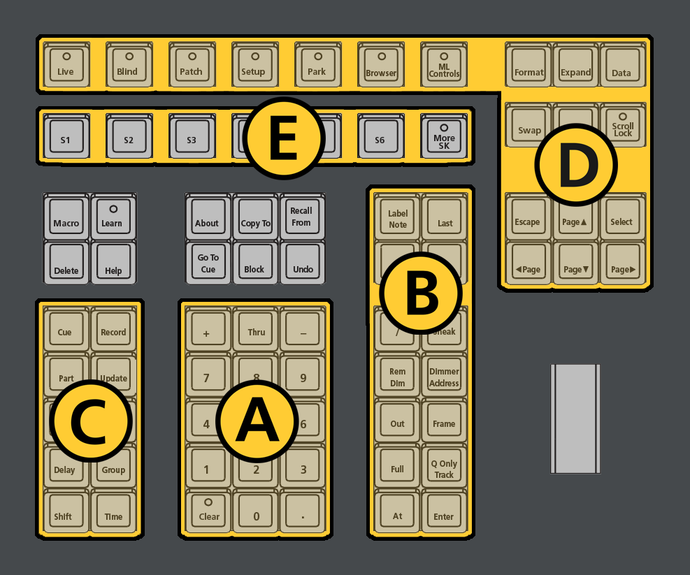

Hardkeys
E Softkeys Softkeys allow physical control of context-based software options that change in response to the active display or command line syntax, including the onscreen softkey options, offering additional commands not available on hardkeys.
Backlight
Main Playbacks
Faders
In addition to the main playbacks, banks of configurable faders are provided. The faders may be configured as playbacks, submasters, grandmasters, timing masters, effects masters, targets, or target lists. One hundred virtual pages of 10 faders each are provided.
Fader Selection Wheel
The fader selection wheel switches the fader banks between direct control of channels and submasters.
Fader Buttons
Ion Xe 20, Element 2, and Element Classic consoles lack dedicated load buttons for assigning a specified target to a specified fader, other than for the main playbacks. For all other faders, load is performed with a simultaneous press of the two bump buttons beneath the fader. See Assigning Faders.
Level Wheel
DMX Ports
In order to output control levels from your console, you can use the DMX ports on the back of the console and/or you may connect a gateway or node. If your device receives sACN or Art-Net directly, no gateway or node is required.
To output, connect one 5 pin XLR cable per port. The first port will default to outputting the first universe of DMX, addresses 1-512, the second port to the second universe, outputting addresses 513-1024, and so on.
See Local Output for information on reconfiguring the DMX ports.
Ethernet Ports
USB Ports
One USB port is provided on the front of the console to connect any USB storage device. Additional USB ports on the rear panel (and in the keyboard tray, when present) of the console connect peripherals such as an alphanumeric keyboard, pointing device, or touchscreen control for external monitors.
Task Lights
Littlites®
Pin 2 0 VDC.
Pin 3 +12 VDC.

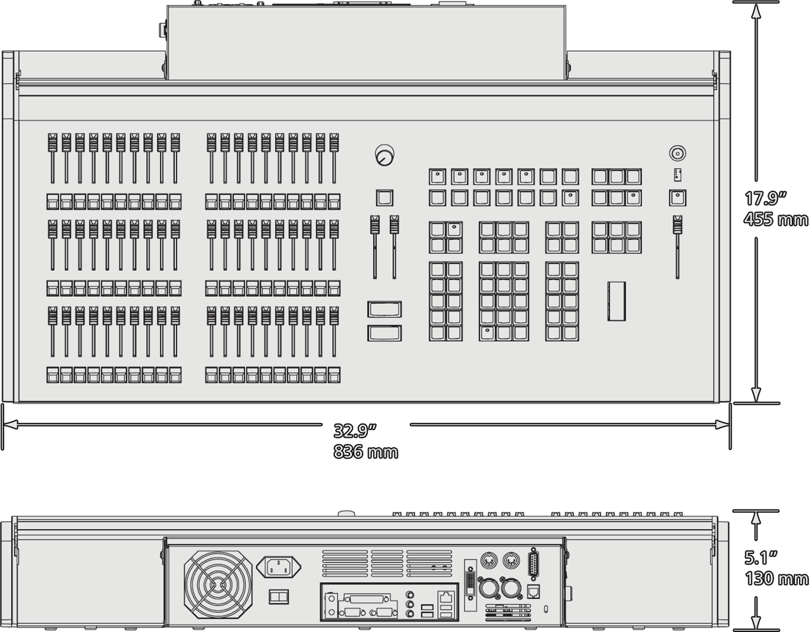

Dimensions and Weights
mm in mm in mm in kg lb
Element Classic 130 5.1 836 32.9 455 17.9 13.6 30
