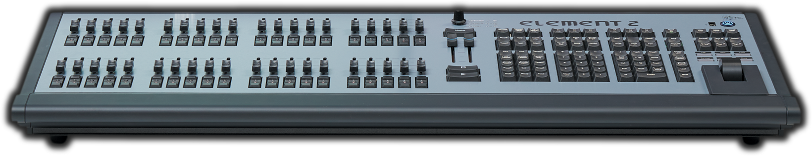

Element 2
Designed for venues using primarily conventional lighting, the Element 2 control console provides the powerful features of the Eos system in an economical and simplified package.

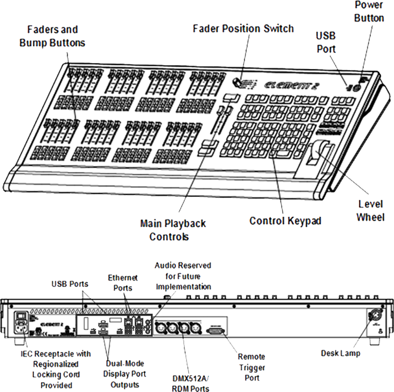

Physical Overview
Element 2 hardware layout.
Element 2 capabilities.

DMX Ports
In order to output control levels from your console, you can use the DMX ports on the back of the console and/or you may connect a gateway or node. If your device receives sACN or Art-Net directly, no gateway or node is required.
To output, connect one 5 pin XLR cable per port. The first port will default to outputting the first universe of DMX, addresses 1-512, the second port to the second universe, outputting addresses 513-1024, and so on.
See Local Output for information on reconfiguring the DMX ports.
Ethernet Ports
USB Ports
One USB port is provided on the front of the console to connect any USB storage device. Additional USB ports on the rear panel (and in the keyboard tray, when present) of the console connect peripherals such as an alphanumeric keyboard, pointing device, or touchscreen control for external monitors.

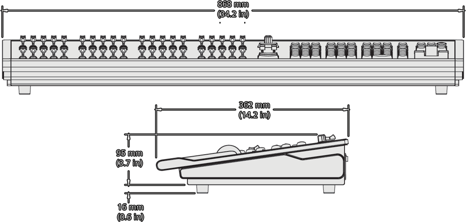

Dimensions and Weights
mm in mm in mm in kg lb
Element 2 111 4.3 868 34.2 362 14.2 7.26 16.0
Element 2 in shipping container 241 9.5 1022 40.3 495 19.5 9.25 20.4
Element 2 in travel case 212 8.3 1146 45.1 494 19.5 18.94 41.8
