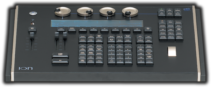

Ion Classic
The Ion Classic control console provides fully-integrated control of LED, conventional and moving lights in a compact, portable package.

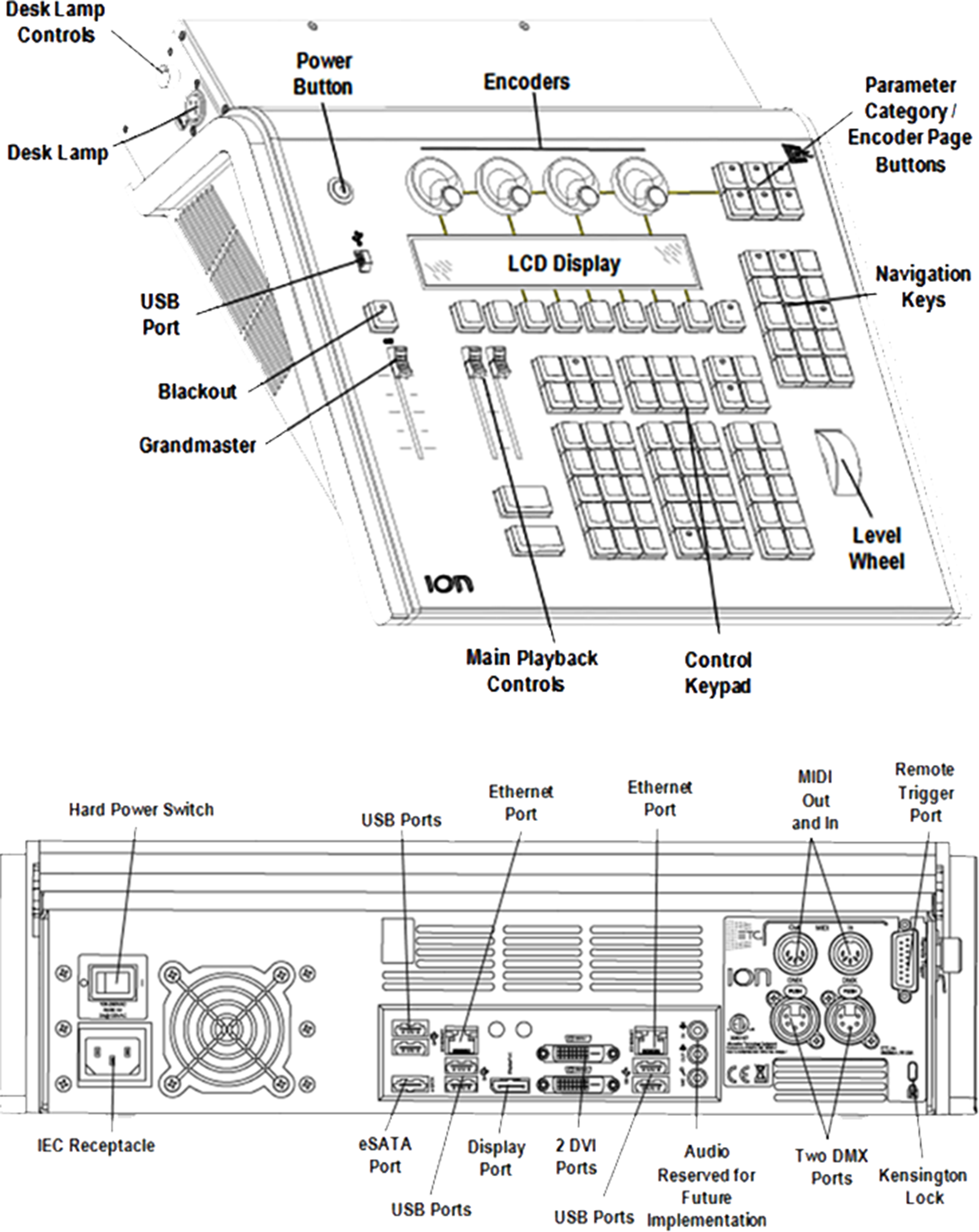

Physical Overview
Ion Classic hardware layout.
Ion Classic capabilities.

Physical Overview
Power
Power Button
The soft power button on the front of your device is used to power it up or down. You can also power down your device via {Power Off Device} in the Browser.
Hard Power Switch
A separate hard power switch, located on the rear panel above or below the power cord socket, supplies or disconnects power from the console’s internal components.
CAUTION: It is recommended that you safely power down before disconnecting power from the console.
WARNING: Before servicing your console, you must switch off the power on the rear panel and disconnect the power cord completely.
Battery
WARNING: This device contains a lithium battery. Battery may explode if mistreated. Do not recharge, disassemble or dispose of in fire.
External Monitors
CAUTION: Eos consoles without internal monitors (Ion Xe, Ion Xe 20, Element 2, Ion Classic, and Element Classic) must have at least one external monitor connected for the Eos application to initialize.
Windows 7 Ion Classic can support up to 2 monitors: either 2 DVI monitors, or 1 Display Port and 1 DVI.
Display Port can use an active adapter to VGA, DVI, or HDMI. DVI-I can be converted to VGA with a passive adapter.
Output to 4K resolution monitors may affect console performance. ETC recommends an external monitor resolution of 1024 or lower for use with Ion Classic consoles.

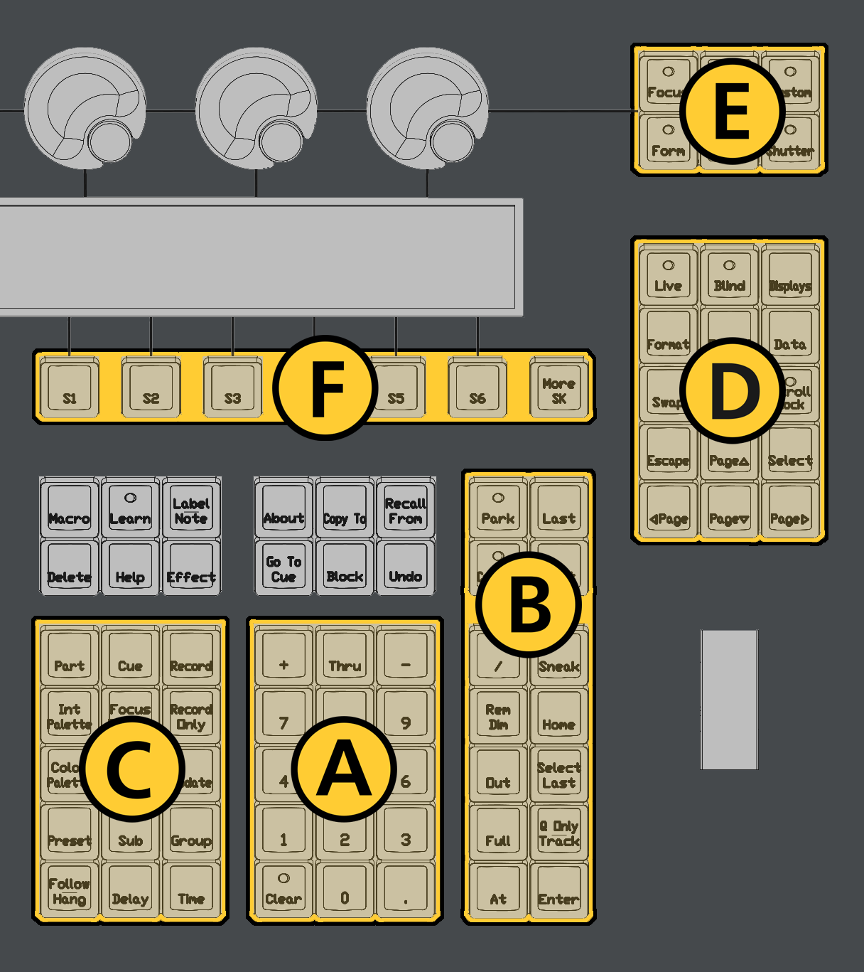

Hardkeys
The backlit hardkeys provided on the face panel are divided into several sections based on their functionality.
A Keypad The numeric keypad allows you to type numbers for channel or target selection via the command line, along with modifier keys to alter your selection.
B Level Controls The level controls provide options for altering the intensity levels of channels, along with a number of other non-intensity parameters / targets.
C Targets The target controls provide options for altering a variety of record targets, as well as shortcuts to various Blind displays.
D Display and Navigation The display and navigation keys provide quick access to common displays, formatting, paging, and navigation within displays.
E Encoder Categories The encoder category buttons allow expanded control of a variety of fixture parameters, along with additional softkey options where applicable.
F Softkeys Softkeys allow physical control of context-based software options that change in response to the active display or command line syntax, including the onscreen softkey options, offering additional commands not available on hardkeys.

Encoders
Encoders and an associated LCD for control of non-intensity parameters are provided at the top center of the console. The four encoders are pageable controls, which are populated on the LCD with the parameters used in your show.
LCD
This display accompanies the CIA as an additional user interface. This LCD offers you softkeys, encoder information, and an additional view of the command line. To adjust the brightness and contrast levels of the LCD, go to Setup > Device > Brightness Settings and Presets > Ion Display.
Level Wheel
The level wheel adjusts intensity up or down for any selected channels. With channels selected, roll the wheel up to increase intensity, or down to decrease it.
The level wheel can provide additional functions via Eos Console Hardkey Shortcuts when combined with various other console keys.
DMX Ports
In order to output control levels from your console, you can use the DMX ports on the back of the console and/or you may connect a gateway or node. If your device receives sACN or Art-Net directly, no gateway or node is required.
To output, connect one 5 pin XLR cable per port. The first port will default to outputting the first universe of DMX, addresses 1-512, the second port to the second universe, outputting addresses 513-1024, and so on.
See Local Output for information on reconfiguring the DMX ports.
Ethernet Ports
Ethernet ports are for connecting to a network switch, network gateways, and accessory devices. Each port can be run as a separate NIC, and can be configured to directly output network-based lighting control protocols such as sACN or Art-Net.
See Patch > Protocols and Setup > Device > Network.
USB Ports
One USB port is provided on the front of the console to connect any USB storage device. Additional USB ports on the rear panel (and in the keyboard tray, when present) of the console connect peripherals such as an alphanumeric keyboard, pointing device, or touchscreen control for external monitors.
USB data ports cannot be used for charging devices.
Task Lights
Littlites®
Littlites can be connected to the back of your console.
One Littllite is included. Littlite XLR connectors use the following pinout:
Pin 1 Chassis ground. Jumpered to ground lug.
Pin 2 0 VDC.
Pin 3 +12 VDC.
Dimming Task Lights
Task lights can be dimmed from within Eos, under Setup > Device > Brightness Settings and Presets. The {Desk Lamp} slider has a range of 0% (dimmest) to 100% (brightest). The default setting is 0%. The console will set the desk lamp to this setting on startup of the application.
Task lights can also be controlled by holding down [Displays] and rolling the level wheel.

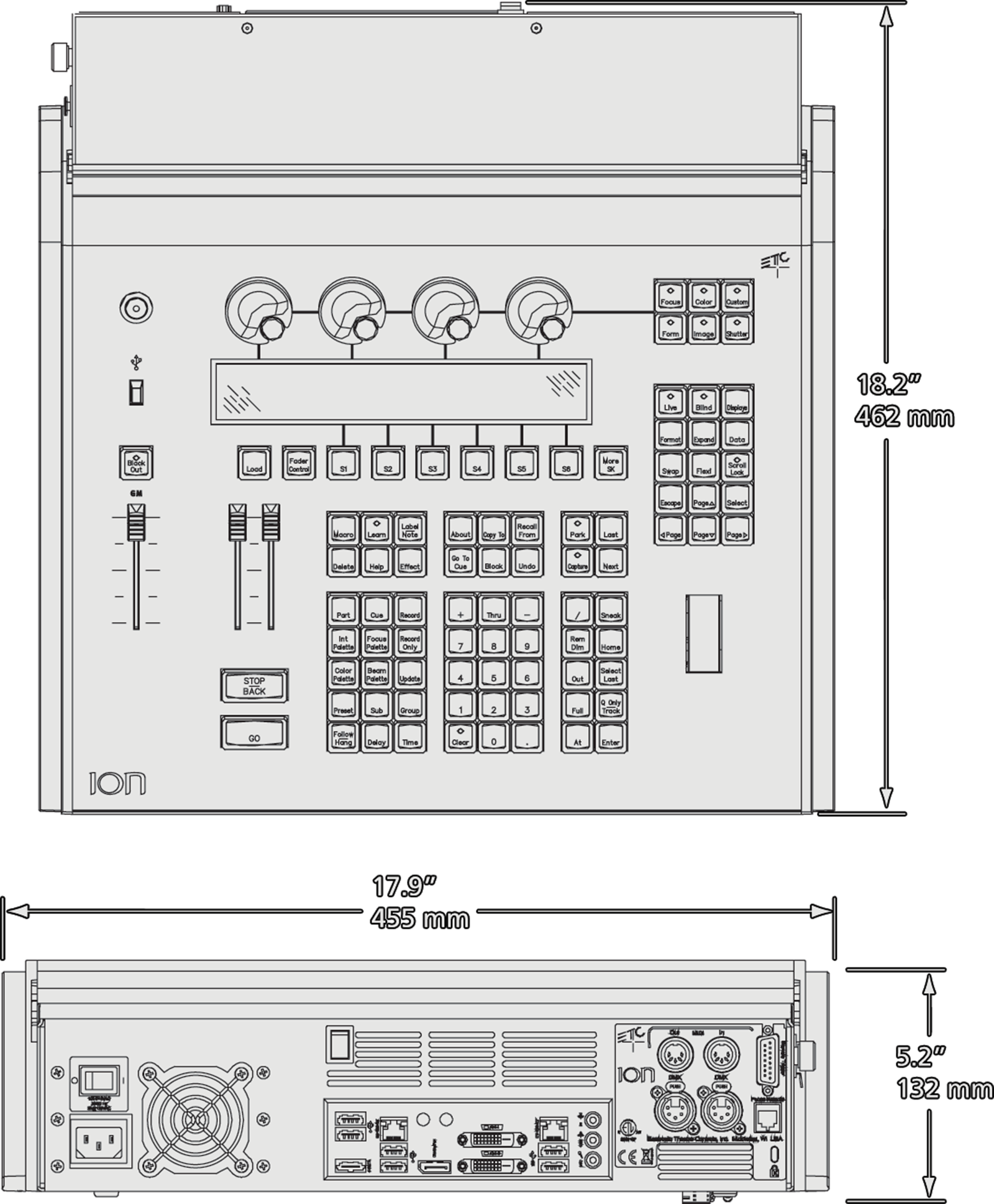

Dimensions and Weights
Model Height Width Depth Weight
mm in mm in mm in kg lb
Ion Classic 132 5.2 455 17.9 462 18.2 9.23 20.35
