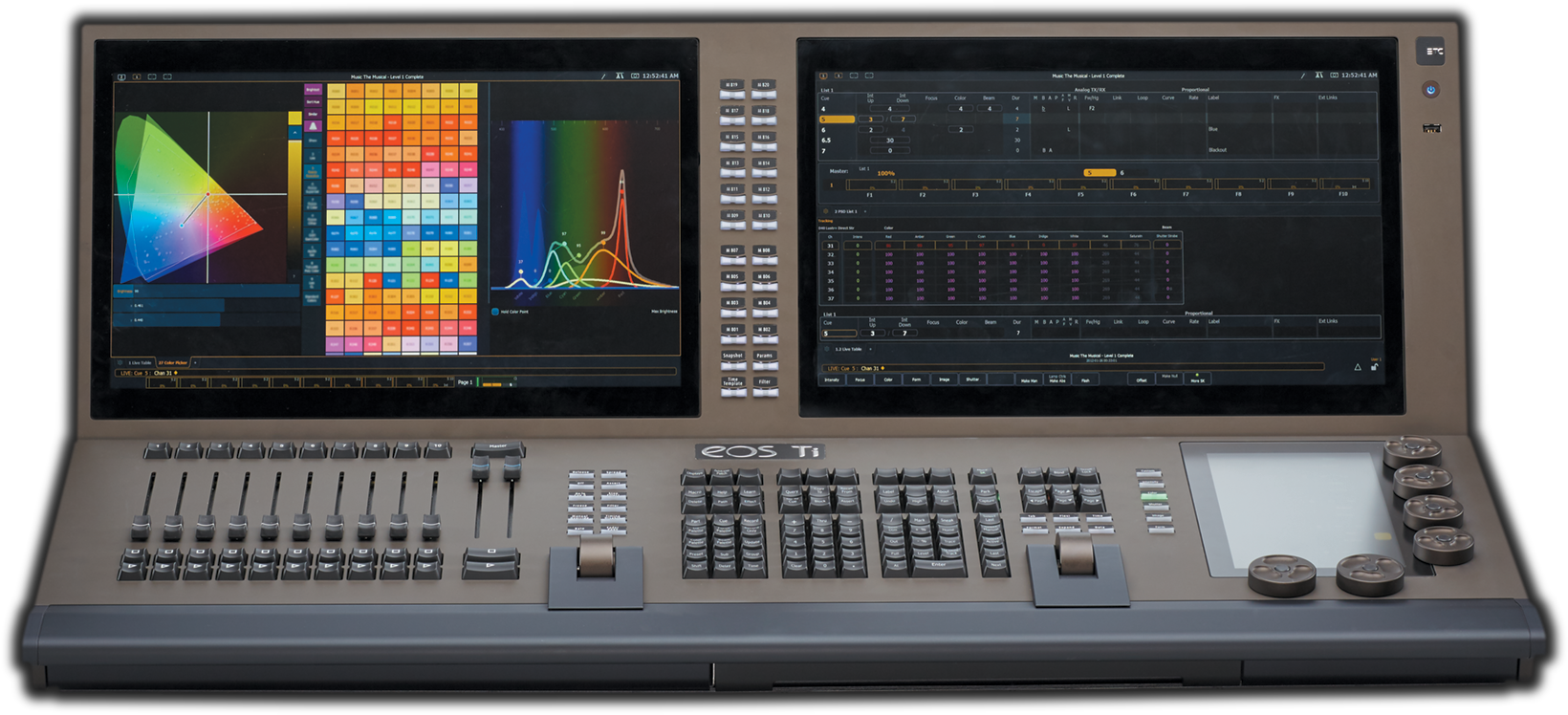

Physical Overview
Eos Ti hardware layout.
Eos Ti capabilities.

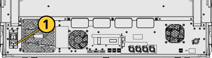

  1. Insert the included power cord, locking it into the IEC socket under the hard power switch on the back of the device. Connect the other end of the cord to wall power.
    CAUTION: Power cord must be connected using an earth ground connection.

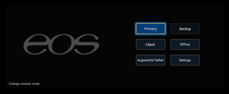

  7. Choose one of the Supported Eos Device Roles to log into the Eos application.

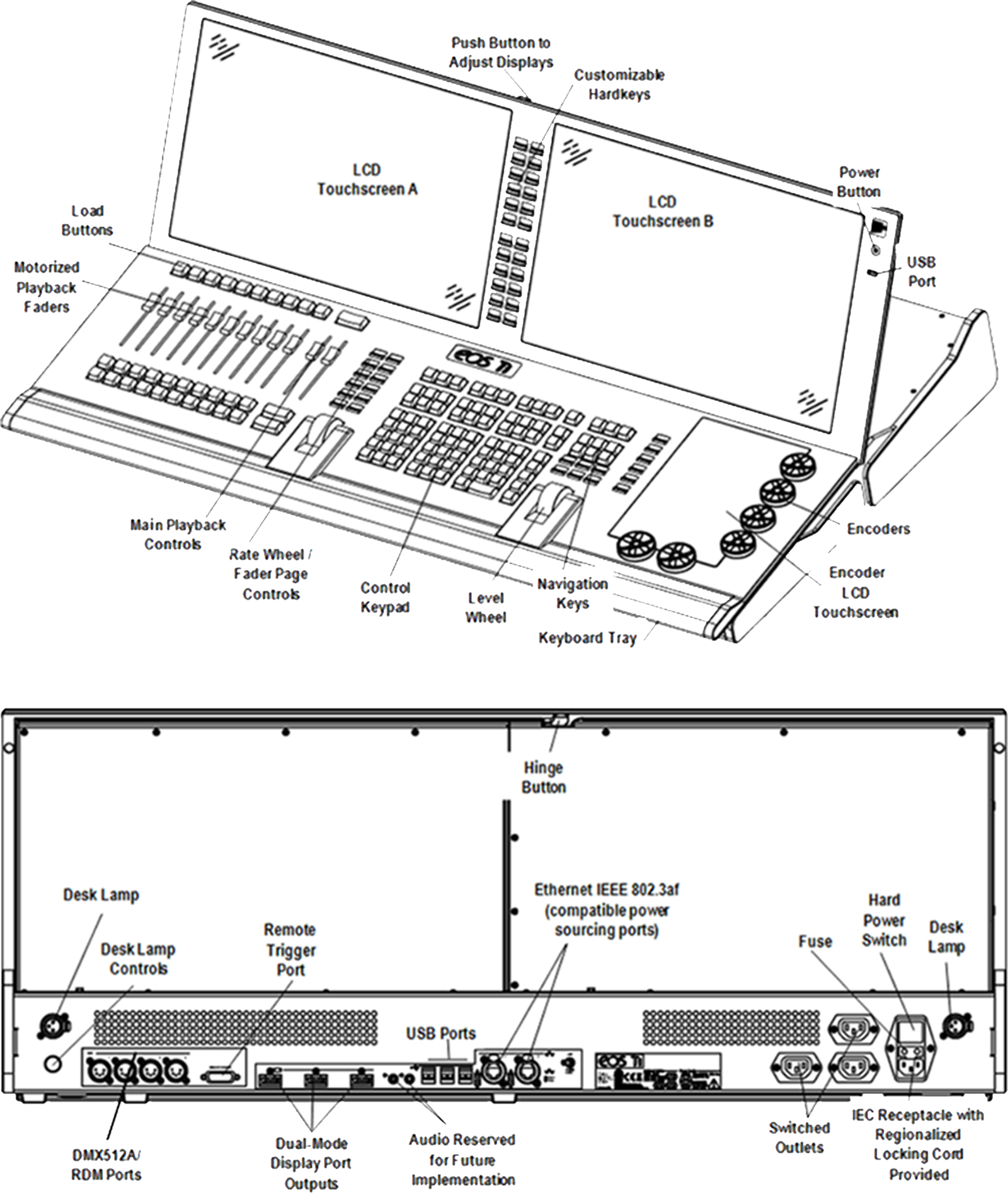

Physical Overview
Power
Power Button
The soft power button on the front of your device is used to power it up or down. You can also power down your device via {Power Off Device} in the Browser.

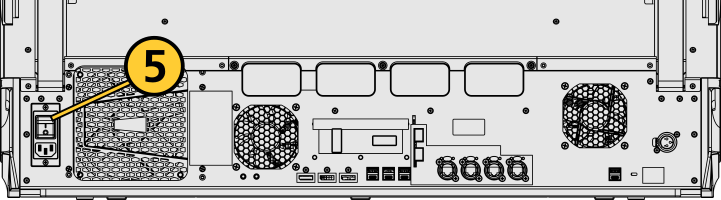

Hard Power Switch
A separate hard power switch, located on the rear panel above or below the power cord socket, supplies or disconnects power from the console’s internal components.
CAUTION: It is recommended that you safely power down before disconnecting power from the console.
WARNING: Before servicing your console, you must switch off the power on the rear panel and disconnect the power cord completely.
Fuse
A fuse is included for additional protection. Fuse ratings can be found on the rear panel of your console.

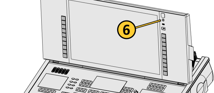

Internal Touchscreens
Eos Ti is designed with three internal touchscreen displays.
  • The two main touchscreens may be used to display and control show data. They may also be used as a variety of other virtual controls and displays.
  • The encoder touchscreen offers additional touch-based controls for encoder parameters.
The touchscreen angle can be adjusted by pushing the button in the center top of the display and moving the panel up or down.
Touchscreen brightness can be controlled via Setup > Device > Brightness Settings and Presets.

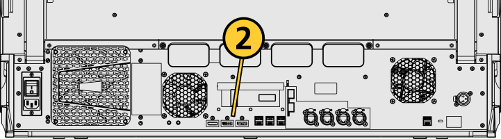

External Monitors
Eos Ti and Gio consoles support up to three external Display Port or DVI monitors compatible with Windows 7 or later.
Monitor Specifications for Display Port Devices
  • Display resolutions from 1920x1080 to 3480x2160 (4K) are supported.
    • DisplayPort v1.2. maximum resolution 3480x2160 (60Hz refresh rate). Video adapters may have their own ratings and limits.
  • Each display may be utilized in landscape or portrait mode.
  • Multi-touch display support requires:
    • Data connection via USB-A or USB-C cable per multi-touch monitor.
    • Windows Human Interface Device (HID) compliant touch displays, utilizing Windows standard driver.
    • Displays must process five or more points of simultaneous touch.
  • Display Data Channel / Control Interface (DDC/CI) is supported for control of external monitor brightness.
Monitor Specifications for DVI Devices
  • Maximum digital resolution 2560x1600 (30Hz refresh rate) or 1920x1200 (60Hz refresh rate).
  • Maximum VGA resolution 2048x1536 (30Hz refresh rate) or 1920x1200 (60Hz refresh rate).
  • Output to 4K resolution monitors may affect performance.
External monitors that support Display Data Channel / Command Interface (DDC/CI) via Display Port can be dimmed from Eos via to Setup > Device > Brightness Settings and Presets.

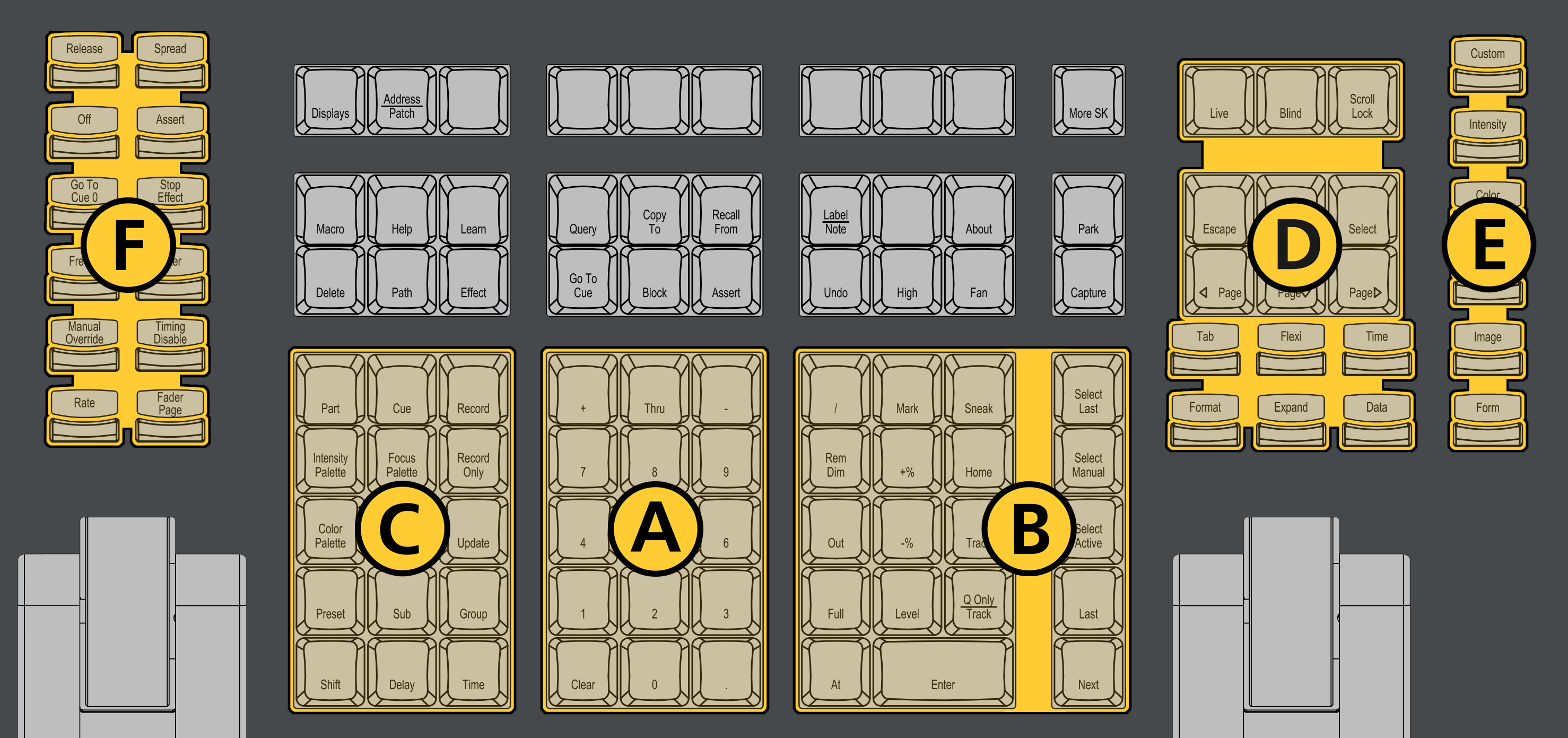

Hardkeys
The backlit hardkeys provided on the face panel are divided into several sections based on their functionality.
A Keypad The numeric keypad allows you to type numbers for channel or target selection via the command line, along with modifier keys to alter your selection.
B Level Controls The level controls provide options for altering the intensity levels of channels, along with a number of other non-intensity parameters / targets.
C Targets The target controls provide options for altering a variety of record targets, as well as shortcuts to various Blind displays.
D Display and Navigation The display and navigation keys provide quick access to common displays, formatting, paging, and navigation within displays.
E Encoder Categories The encoder category buttons allow expanded control of a variety of fixture parameters, along with additional softkey options where applicable.
F Fader Controls The fader control buttons provide additional options for easy local control of fader behavior.
Additional Targets & Functions
Other hardkeys provide options for a variety of common console functions and shortcuts to various Blind displays.

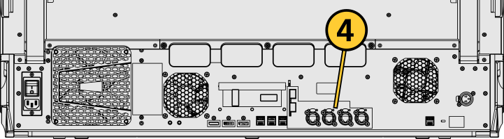

DMX Ports
In order to output control levels from your console, you can use the DMX ports on the back of the console and/or you may connect a gateway or node. If your device receives sACN or Art-Net directly, no gateway or node is required.
To output, connect one 5 pin XLR cable per port. The first port will default to outputting the first universe of DMX, addresses 1-512, the second port to the second universe, outputting addresses 513-1024, and so on.
See Local Output for information on reconfiguring the DMX ports.
Ethernet Ports
Ethernet ports are for connecting to a network switch, network gateways, and accessory devices. Each port can be run as a separate NIC, and can be configured to directly output network-based lighting control protocols such as sACN or Art-Net.
See Patch > Protocols and Setup > Device > Network.
USB Ports
One USB port is provided on the front of the console to connect any USB storage device. Additional USB ports on the rear panel (and in the keyboard tray, when present) of the console connect peripherals such as an alphanumeric keyboard, pointing device, or touchscreen control for external monitors.
USB data ports cannot be used for charging devices.

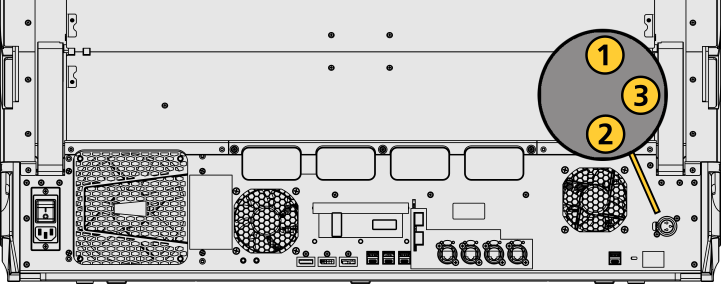

Littlites®
Littlites can be connected to the back of your console.
One Littllite is included. Littlite XLR connectors use the following pinout:
Pin 1 Chassis ground. Jumpered to ground lug.
Pin 2 0 VDC.
Pin 3 +12 VDC.

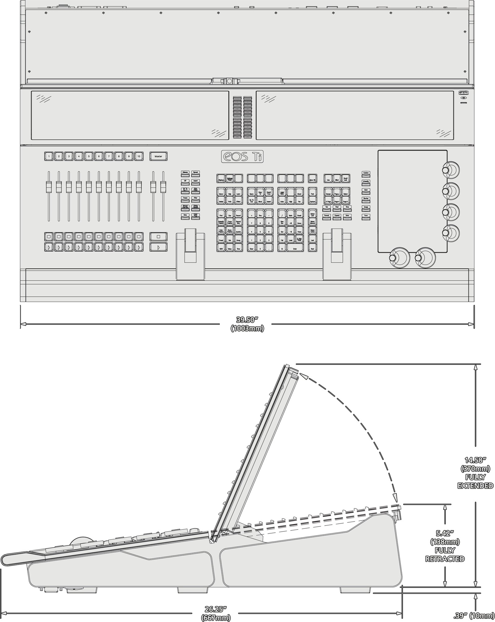

Dimensions and Weights
Model Height Width Depth Weight
mm in mm in mm in kg lb
Eos Ti 370 14.58 1003 39.50 667 26.25 38.5 85
Eos Ti in shipping container 356 14 1143 45 787 31 54.5 120
Eos Ti in travel case 940 37 1155 45.5 270 10.6 68 150
The Eos Ti can be used in the following Eos Device Roles:
    • Primary- the device designated as operating the session.
  • Expansion Processor (EEP) - a device logged into Expansion Processing mode for processing and outputting additional universes of data.
    • Backup Eos Expansion Processor (BEEP) - a device logged into Expansion Processing mode, assigned to track an EEP and take over in the event of failure.
