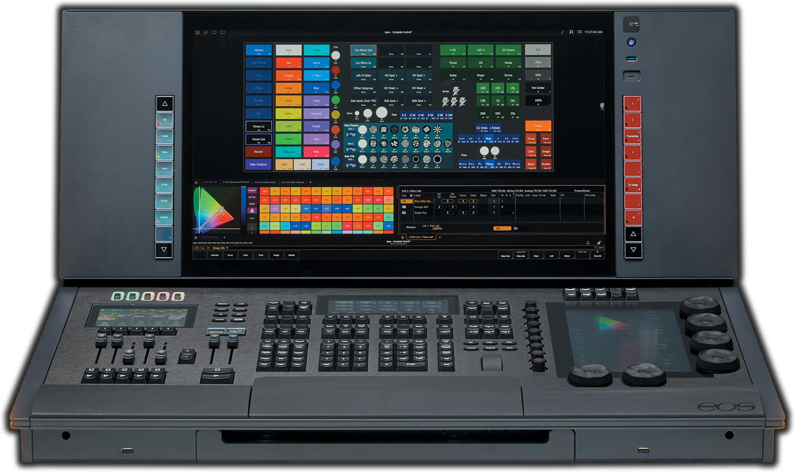

Eos Apex 5
The Eos Apex 5 console is the compact powerhouse of ETC’s flagship lighting controllers, and is engineered for comfort and customization on the go. The condensed programming surface provides access to all of the same tools as the larger Apex desks, in a portable form factor.

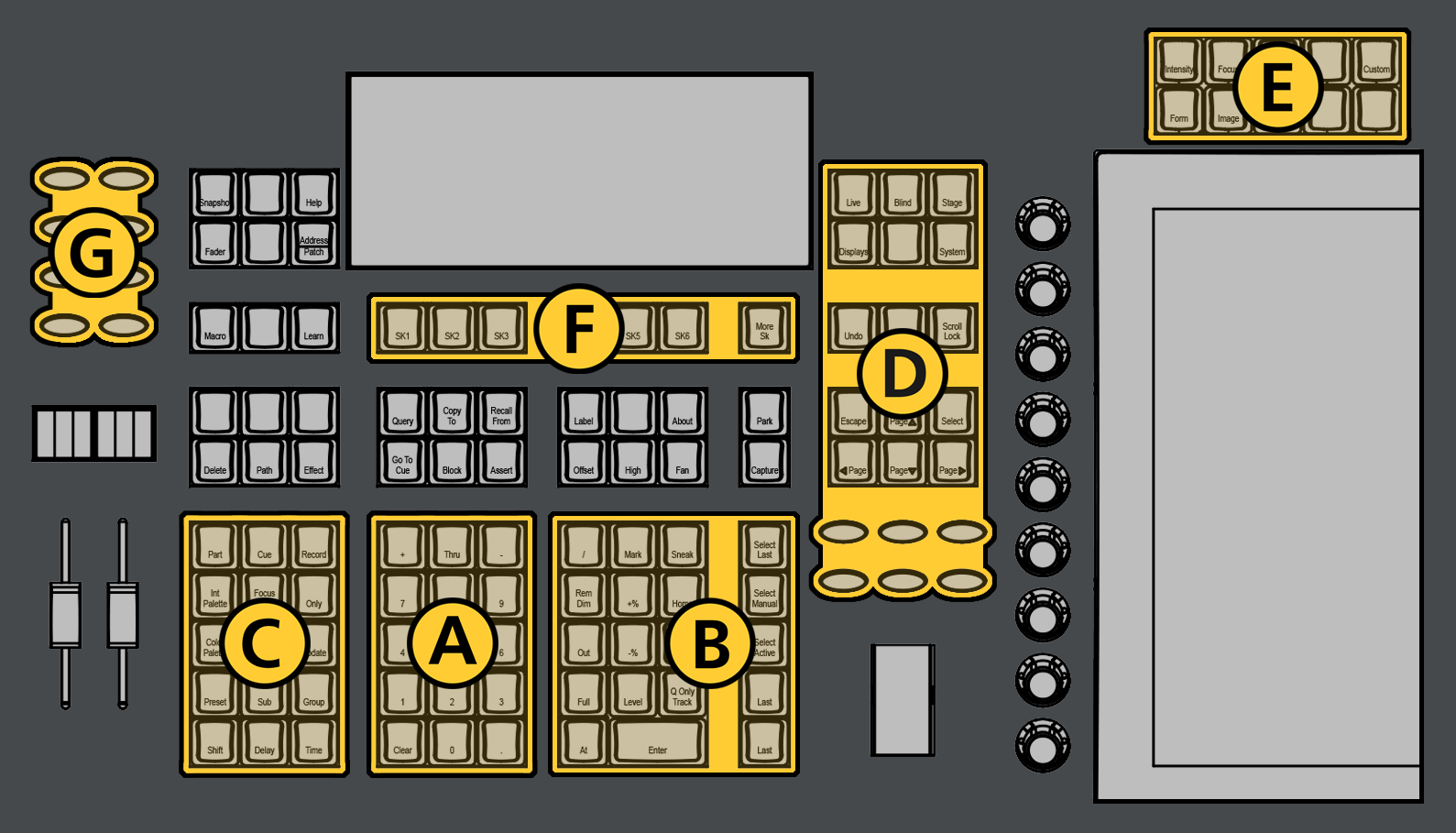

Hardkeys
E Encoder Categories The encoder category buttons allow expanded control of a variety of fixture parameters, along with additional softkey options where applicable.
F Softkeys Softkeys allow physical control of context-based software options that change in response to the active display or command line syntax, including the onscreen softkey options, offering additional commands not available on hardkeys.
G Fader Controls The fader control buttons provide additional options for easy local control of fader behavior.

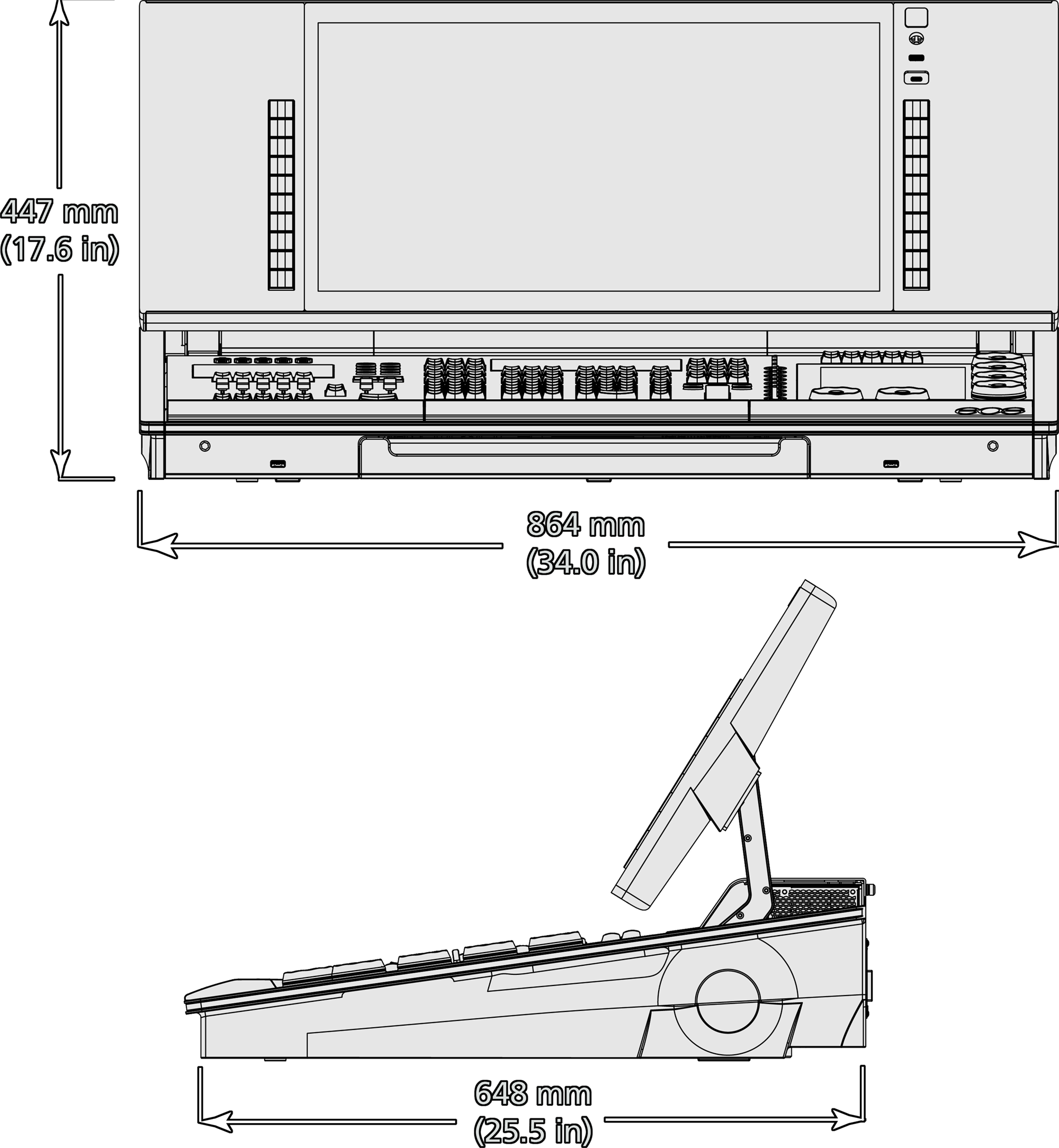

Dimensions and Weights
mm in mm in mm in kg lb
Eos Apex 5 447 17.6 864 34.0 648 25.5 44 97
Eos Apex 5 in shipping container 318 12.5 966 48.0 794 31.3 TBD TBD
Eos Apex 5 in travel case 926 36.4 1023 40.3 388 15.3 TBD TBD
