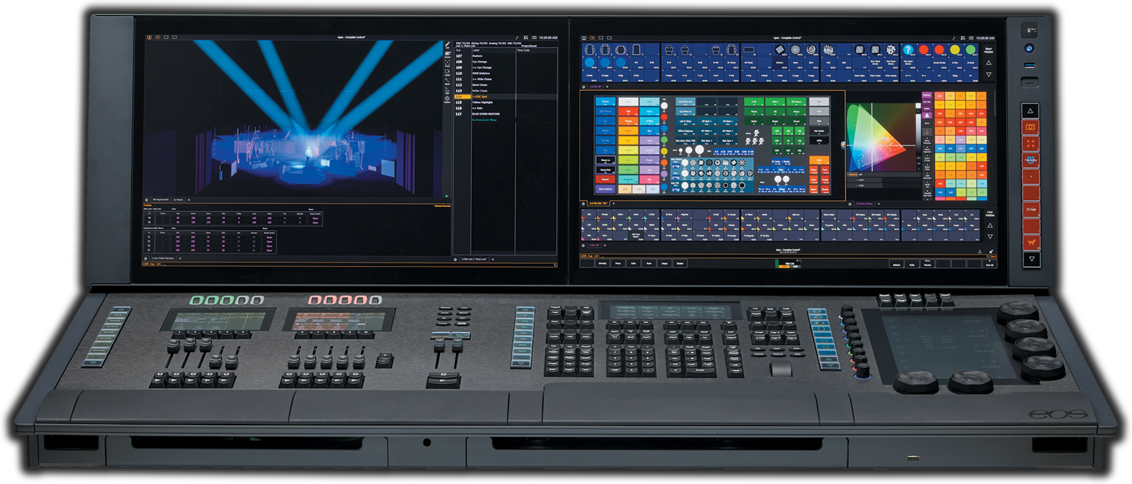

Internal Touchscreens
Apex consoles are designed with one (Apex 5) or two (Apex 10 and 20) internal touchscreen displays, supporting haptic feedback or pressure-sensitive touch. The main touchscreens may be used to display and control show data. They may also be used as a variety of other virtual controls and displays.
Touchscreen position can be changed by freely adjusting the screen panel's height and angle.

Hardkeys
E Encoder Categories The encoder category buttons allow expanded control of a variety of fixture parameters, along with additional softkey options where applicable.
F Softkeys Softkeys allow physical control of context-based software options that change in response to the active display or command line syntax, including the onscreen softkey options, offering additional commands not available on hardkeys.
G Fader Controls The fader control buttons provide additional options for easy local control of fader behavior.
Backlight
Keypad Touchscreen
Apex consoles include a haptic touch-enabled screen above the keypad that can be configured to control custom direct selects or magic sheets.
Softkeys and a gear icon to access screen settings are docked at the bottom of this display.
Target Keys
Apex consoles offer multiple banks of Target Keys, physical buttons with built-in high-resolution displays.
  • Apex 5 - 20 Target Keys (2 banks of 10).
  • Apex 10 - 40 Target Keys (4 banks of 10).
  • Apex 20 - 50 Target Keys (5 banks of 10).
All Apex consoles also offer two target keys over the main playback faders for dedicated load functionality, as well as local status of playback content.
Main Playbacks
Motorized Faders
In addition to the main playbacks, five, ten, or twenty slots of configurable motorized faders are provided. The faders may be configured as playbacks, submasters, grandmasters, timing masters, effects masters, targets, or target lists. One hundred virtual pages of 10 faders each are provided.
Fader Touchscreens
Each bank of five faders has a dedicated multi-touch display for local status of playback content.
Fader Buttons
Load buttons, located directly above each fader, are used when Assigning Faders to load a specified target to the associated fader, or to place special conditions on that fader.
Endless Fader Wheels
Apex consoles offer five, ten, or twenty detented, color-changing fader wheels, adding an endless fader and additional button to each overall fader slot. When Changing Fader Pages, each fader wheel and button is paged independently of the faders below them, effectively doubling the control capabilities of each fader slot.
Encoders
Haptic-feedback encoders and an associated touchscreen for control of non-intensity parameters are provided on the lower right of the console. The two larger encoders at the bottom are dedicated pan and tilt controls. The remaining four encoders on the right side of the console are pageable controls. By default, these encoders are populated on the touchscreen with the parameters used in your show. They can also be custom mapped.
Mini Encoders
Apex consoles also offer nine RGB-backlit mini encoders to the left of the encoder touchscreen. Eight of the mini encoders can be fully configured for expanded control of the large encoder parameters, or can have custom mapping. The bottom encoder is dedicated to mini encoder paging and configuration.
Level Wheel
IO Garage
Apex consoles come equipped with four input / output bays for custom configuration of the available data ports on the back of the console, collectively known as the IO garage.
Any ETC Gadget II or Response Show Control Gateway can be added to the garage and connected internally via USB for local input / output of DMX, MIDI, SMPTE, and other protocols.

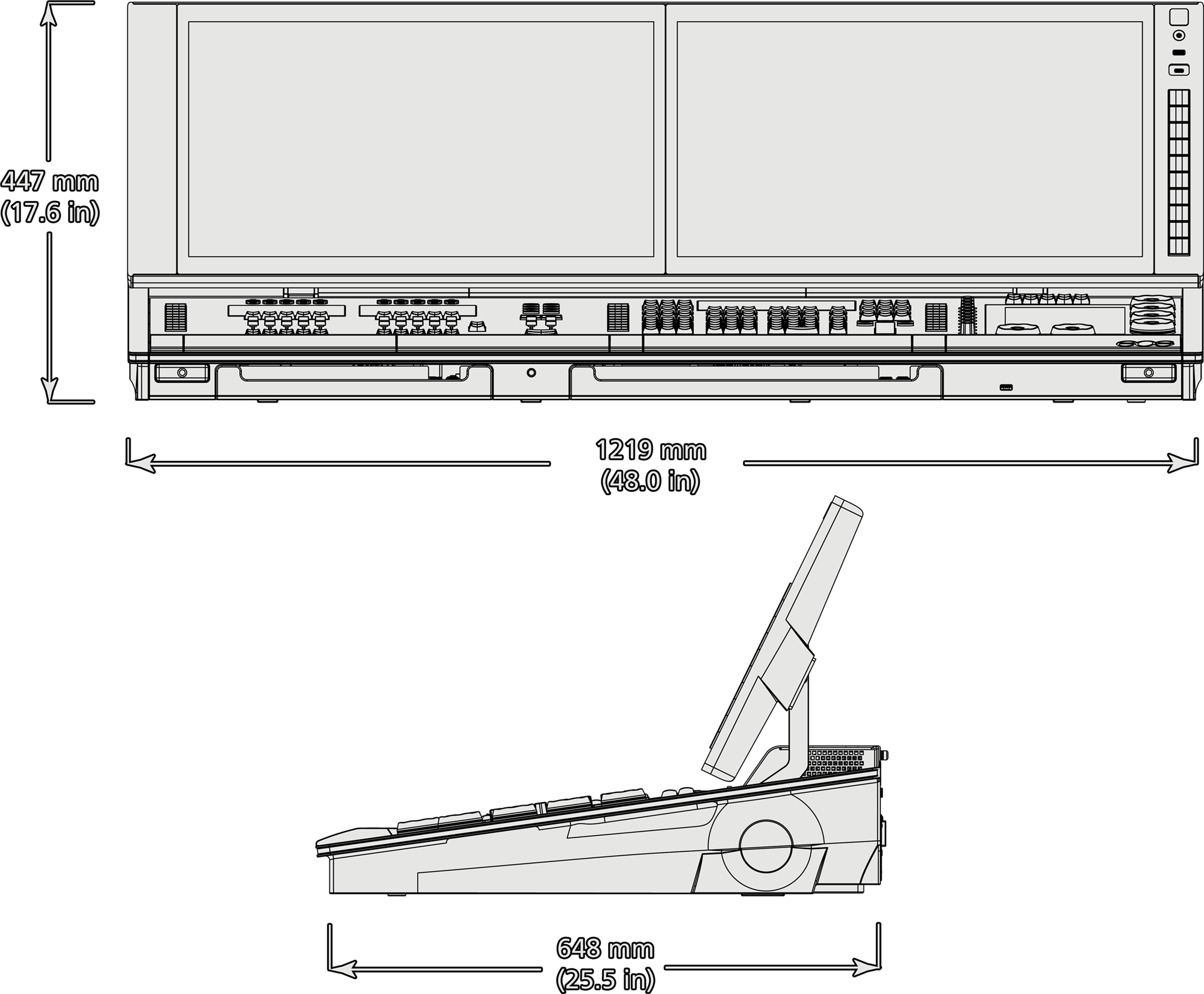

Dimensions and Weights
mm in mm in mm in kg lb
Eos Apex 10 447 17.6 1219 48.0 648 25.5 61.24 135
Eos Apex 10 in shipping container 318 12.5 1330 52.4 794 31.3 TBD TBD
Eos Apex 10 in travel case 926 36.5 388 15.3 1377 54.3 TBD TBD
