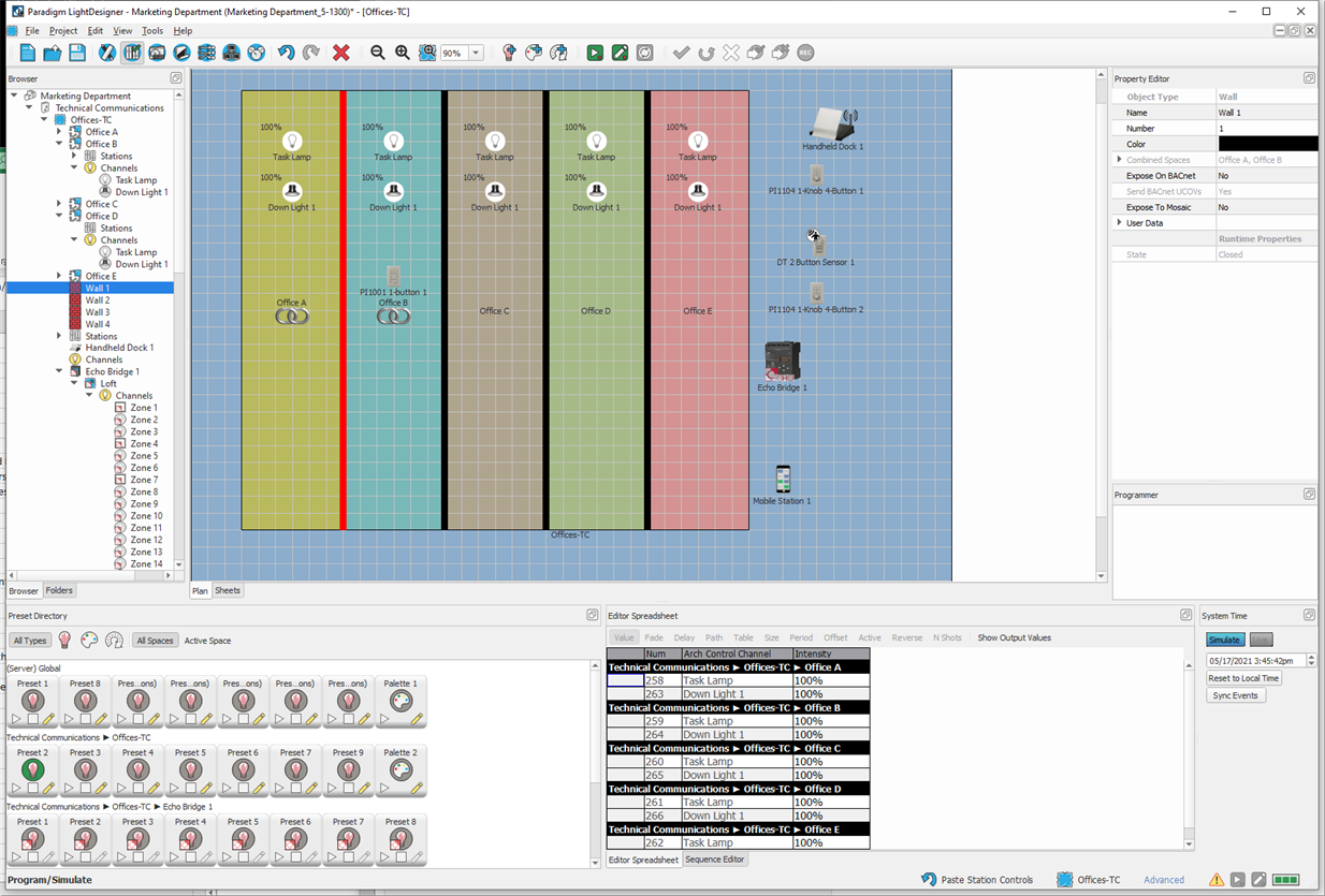

Display Overview
Much of the display looks very similar to the Design view with added features for programming and simulation and editing of controls. The Preset Directory, Editor Spreadsheet, and Sequence Editor are provided to create, edit, and organize presets, palettes, and sequences in the project.
The Programmer, located beneath the Property Editor by default, as well as the tools in the toolbar, provide access to programming and editing of the configuration, and live control of the entire system.
- The Preset Directory is a container for all presets, palettes, and sequences created in the project. For server projects, presets, palettes and sequences are sorted by the sub-project they affect. Presets and Sequences that can affect some or all sub-projects (Global) will display at the Server level.
- The Editor Spreadsheet is a comprehensive view of all included channels and their parameter values for the selected space, preset, palette or sequence.
- The Sequence Editor provides a timeline; allowing a user to drag and drop presets and set transitions into a sequence for playback.
- Additionally, there is a Programmer control section beneath the Property Editor. The programmer provides tools to apply or modify control of the selected channel or fixture parameters.
