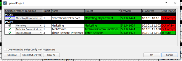

When the LightDesigner configuration file differs from the configuration on connected Paradigm Processor or Paradigm Central Control Server, the synchronization status will display as "Out of Sync" in the device list. Upload the current configuration to the connected Paradigm Processors using the [Upload Project] button in the Network view.
  1. Click the [Upload Project] button located in the Network view. The "Upload Project" dialog displays for processor selection.
  2. Note: From any view within LightDesigner, pressing CTRL+U switches to the Network view and displays the "Upload Project" dialog.
    Network View, Upload Project
  3. All connected Paradigm Processors in the project will display selected for the upload.
    • To exclude a processor from the upload process, click to deselect the processor checkbox.
    • Click [Select All] to select all processors in the project.
    • To select only the processors that are currently out of sync, select [Select Out of Sync].
    • Select [Clear All] to deselect all selected processors in the list.
  4. For projects that include one or more Echo Expansion Bridges, you can choose to overwrite the existing Echo Expansion Bridge configuration data with the project data in the LightDesigner Software configuration by selecting the "Overwrite Echo Bridge Config With Project Data" checkbox.
  5. Note: Selecting this checkbox overwrites the Echo Expansion Bridge configuration data only for bridges that are associated with the selected Paradigm processor(s).
  6. Click [OK]. When the upload process is complete, the processors that received the project upload will display as "In Sync" in the device list.
