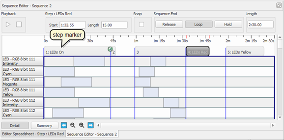

With the sequence in Edit Mode, you may move the entire step in time, or while in the Detail view adjust the timing of individual channels within the step.
- Click the step marker and drag the entire step to the desired time.
- Click and drag individual channels to the desired time within the step.

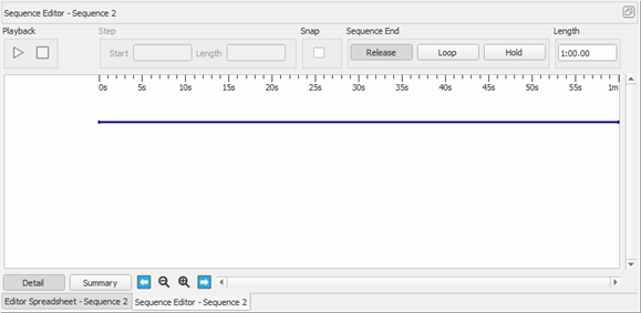

Using the Sequence Editor
With the sequence in Edit Mode, you can change its settings including, snap behavior, sequence end behavior, and the length of the sequence.

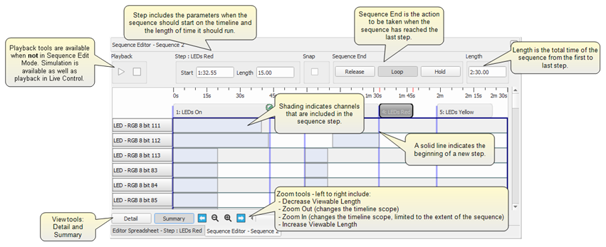

Playback Controls
The Sequence Editor provides a [Start Sequence] and a [Stop Sequence] button for playback of the currently selected sequence. While the sequence is running, the buttons change to [Pause Sequence] and [Stop Sequence]. While the sequence is paused, the buttons change to [Resume Sequence] and [Stop Sequence].

The Sequence Editor provides a Snap checkbox that, when selected, snaps movement of sequence steps and channels to the increment marks on the timeline ruler. The increment marks are determined by the current zoom level.
Set Sequence End Behavior
Configure the Sequence End behavior.
- Release - (default setting) releases all levels applied to output when the sequence completes or reaches its end time using the default system fade time (2s).
- Loop - causes the sequence to loop indefinitely. You must stop or pause the sequence to stop the looping action.
- Hold - holds the levels of the last step in output until another Latest Takes Precedence (LTP) action replaces them (such as Preset Off or Preset Recall).
Length
This property box allows you to indicate the length of time the sequence will run in hours, minutes and seconds (example 1h 1m 3s). This property may not be set less than the end time of the last step in the sequence.

The Sequence Editor offers two view types, the Detail view and the Summary view which are provided as buttons on the bottom left corner of the Sequence Editor.
- [Detail] - (default view) displays channel properties including multi-parameter channels on the timeline which allows for user customization of each parameter timing in the sequence step.
- [Summary] - displays only the channel on the timeline.
The Sequence Editor offers tools to zoom the timeline. From left to right, the Zoom tools include:
- Decrease Viewable Length - moves the timeline to the beginning
- Zoom Out - changes the viewable length of the timeline, reducing the viewed length
- Zoom In - changes the viewable length of the timeline, increasing the viewed length
- Increase Viewable Length - moves the timeline to the end
