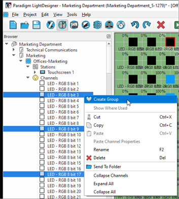

- Select the channels you want to group. Select the channel from the Plan workspace by either clicking and dragging to select multiple channels, or by pressing (CTRL) + and clicking individual channels in either the Plan workspace or the Browser. When a channel is selected, you will notice that it is highlighted in the Plan workspace and in the Browser.
- Right-click on one of the selected channels (either in the Plan workspace or in the Browser) and select "Create Group" from the context menu. The new group will be created with a default name "Group x", where x is an incremented value from the previous Group in the configuration). The new group displays in the Browser under the Groups objects.

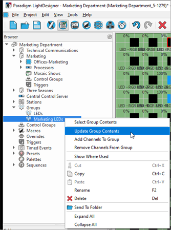

Right-click on the group name in the Browser and select from the many available options in the context menu including Select Group Contents, Update Group Contents, Add Channels To Group, and Remove Channels From Group.
Update the contents of a group by selecting channels / parameters required (pressing CTRL+ click the individual channels to select more than one), then right-click on the group node in the Browser and select "Update Group Contents" from the context menu. The update replaces the group contents with the current channel selection.
