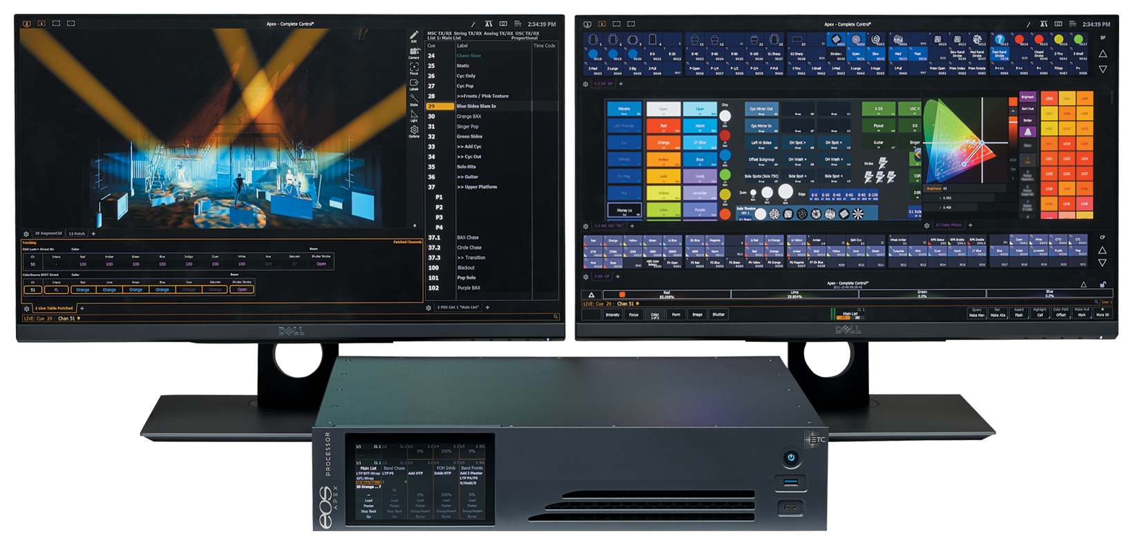

Eos Apex Processor
The Eos Apex Processor carries the same power as Apex consoles, in a 2U 19-inch rack mount unit. It includes the same one- and ten-gigabit Ethernet connections as Apex consoles, making it a great choice to drive a high-powered rig on its own, or serve as a backup to keep large systems running safely.

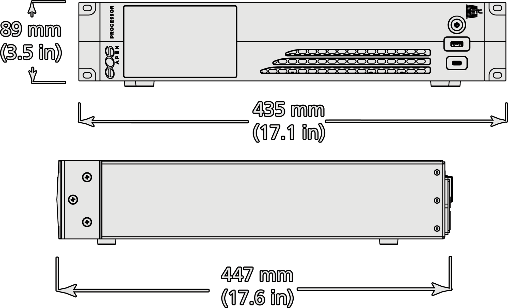

Dimensions and Weights
mm in mm in mm in kg lb
Eos Apex Processor 89 3.5 435 17.1 447 17.6 9.2 20.2
Eos Apex Processor in shipping container 356 14.0 610 24.0 610 24.0 10.4 22.9
