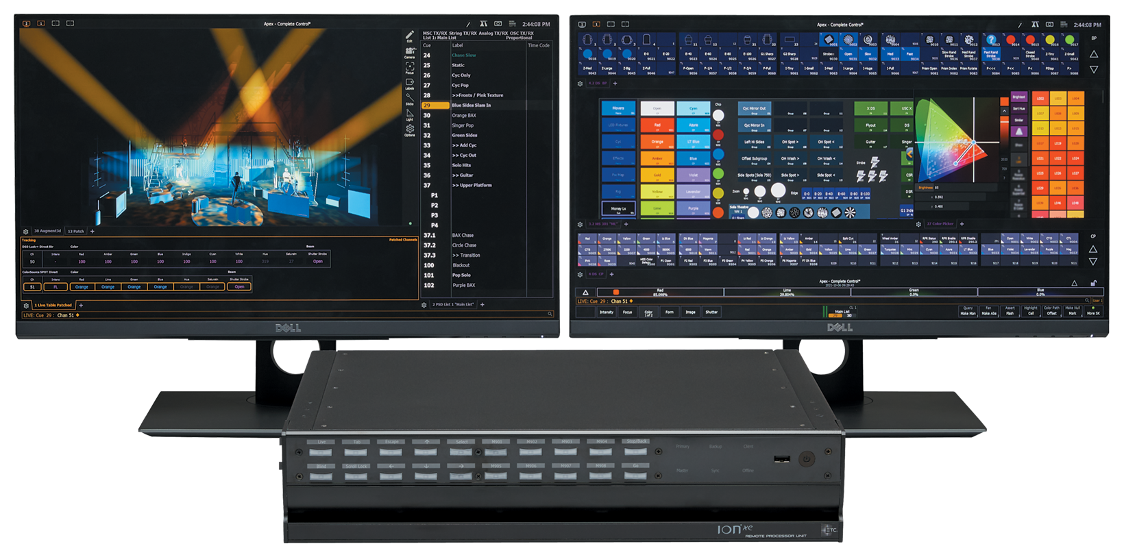

Ion Xe RPU
The Ion Xe Remote Processor Unit (RPU) is a 2U 19-inch rack-mount controller that can serve as a backup for your Ion Xe or Ion Xe 20 lighting control system, or it can function as a stand-alone lighting playback controller. The front panel of the Ion Xe RPU features twenty user-programmable buttons and LED indicators that show mode and status.

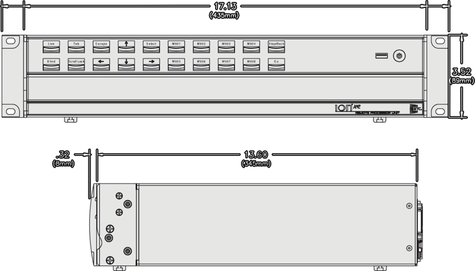

Dimensions and Weights
Model Height Width Depth Weight
mm in mm in mm in kg lb
Ion Xe RPU 447 17.6 864 34.0 648 25.5 44 97
Ion Xe RPU in shipping container 318 12.5 966 48.0 794 31.3 TBD TBD
