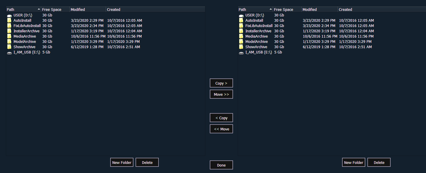

{File Manager...}
Provides a way to manage show files, show data, and software installers. You can create and delete new folders, move, and copy files between the console and USB drives.
The file manager display will show the ShowArchive folder on your console as well as any external USB drives that are detected. The display is split into two windows, so you can see two different folders at the same time for copying or moving data between them.
Template Show Files are stored in a separate Templates folder rather than ShowArchive.

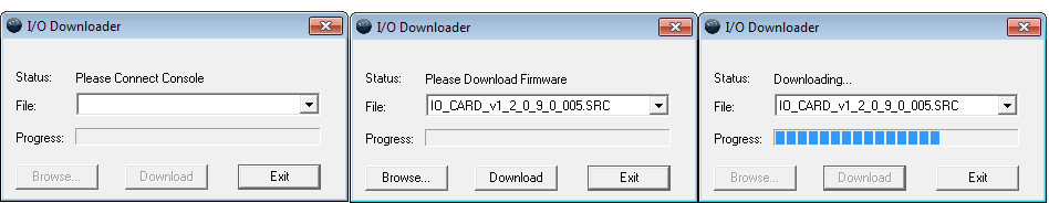

{Upgrade I/O Firmware...}
Upgrades the firmware for single-port Gadgets and consoles with I/O cards that have a phone remote connection. All other devices can use the Firmware Update window below.
When you first open the I/O Downloader, it will look for the connected console. This may take several seconds. Once the console is found, the downloader will search for the needed files. If it finds the file, it will list it and you can click {Download}. If it doesn't find the file, you can use {Browse} to look for the needed file and selected it. Once finished, click {Exit}.

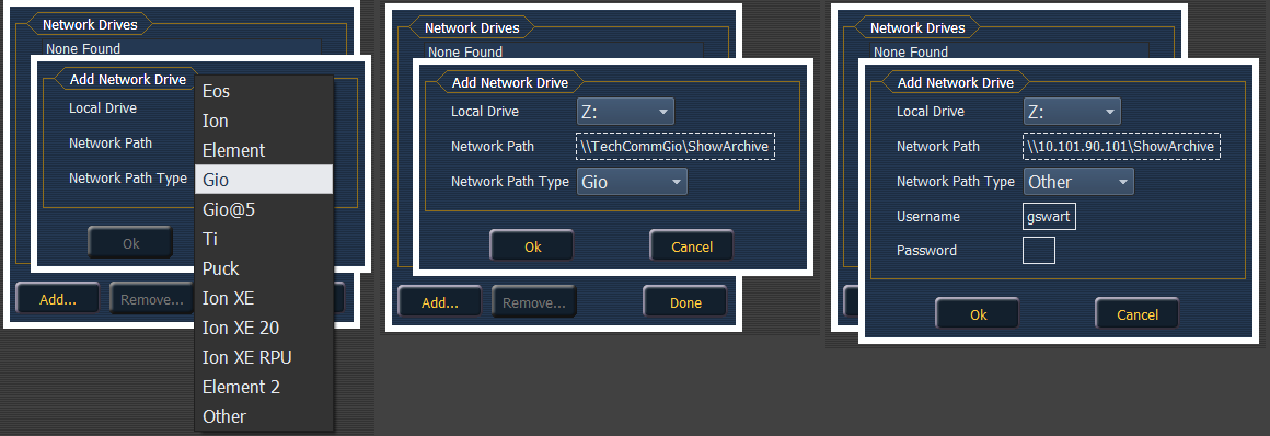

{Network Drives...}
Allows you to select an alternative show file storage location on another console or computer. After setting this location, it will appear as an option within the save and open dialogs in Eos.
In the {Network Drives...} dialog box, there is a {Add} button for mapping a network drive. In the Add Network Drive dialog box, select the drive letter that is appropriate, the network path, and the path type. The network path can use either the IP Address or the Device Name. (Example: \\10.101.90.101\ShowArchive or \\YourDeviceName\ShowArchive) The network path type should match the device. If Other is selected, you will have additional fields to fill out for Username and Password.

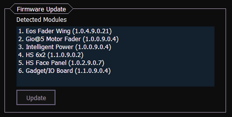

Firmware Update
The firmware update window will display any detected devices that use firmware and may require an update. Devices that need to be updated will display in red.
When a device is selected, the {Update} button will display in yellow if the device can be updated using this window. This includes devices that do not currently need to be updated. If the button is grayed out, the device can not be updated using this window.
Note: Windows 7 consoles must be power-cycled after a firmware update. This is not necessary for consoles running Windows 10.
