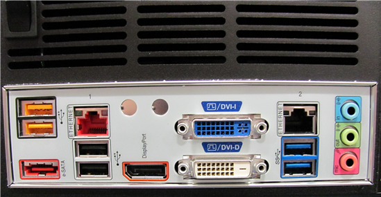

    Ion, Element, Net3 RVI, and Ion RPU may be compatible - after May 2014, they transitioned to Windows 7 Embedded in manufacturing. This came along with some other hardware changes. If your console has connections as shown in the picture below, it will be compatible with touchscreens meeting the requirements below.

    Congo Jr, Congo Kid, Net3 RVI, and Congo Light Server may be compatible - after May 2014, they transitioned to Windows 7 Embedded in manufacturing. This came along with some other hardware changes. If your console has connections as shown in the picture below, it will be compatible with touchscreens meeting the requirements below.
    Ion, Element, Congo Jr, Congo Kid, Net3 RVI, Congo Light Server, and Ion RPU Updated Motherboard
    A. Motherboard
