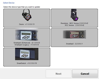

    Step 4)  A display will open with all of the devices that can be updated via the Whip. Click the type of device you are trying to upgrade and click {Next}.
                Step 4

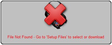

    Please Note, If the software for the device is not found on your computer, this warning will be displayed:
    Step 4b
    The software for the devices can be downloaded from the Setup Versions display, which is available if you close the wizard.

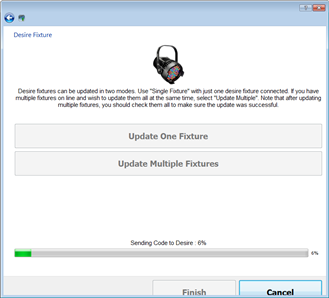

    Step 5)  A device upgrade screen will open with the option to update one or multiple devices. Then click the {Finish} button. The following screens will vary depending on product; the following example is for the Source 4 LED and Desire Product lines.
    Multiple devices can be updated if they are connected to each other via their DMX Thru to DMX In ports. If you elect to upgrade multiple devices at the same time, be aware that the updates will not happen concurrently: one fixture will be updated, then the next, and so on.
     Step 5
    Once the software update begins, you will see a progress bar at the bottom of this screen. Please do not unplug Power or the USB-RS485 converter until the software update is complete.  Doing otherwise may corrupt the firmware in your fixture.
