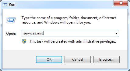

    1. Hold the Windows key and press R, then type services.msc to open the services control panel

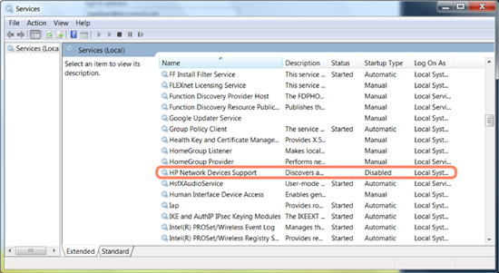

    2. Scroll down and look for a service called "HP Network Devices Support"
    3. Double click on the service, and change the Startup type to Disabled, and press Stop to stop the service.
    4. Press OK, and restart the ETC application you are trying to use. You should now be able to connect.
