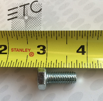

    The Source Four Mini and Mini LED Portable fixtures ship with a smaller C-Clamp than the full-sized Source Four C-Clamp. The smaller clamp has a ‘C’ opening that will accommodate 3/8” to 1” pipe (.675” OD – 1.315” OD). It has a 5/16 in.-18 x 3/4 in. long bolt to connect through the yoke of the fixture.
