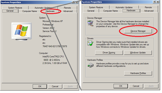

    You will need to install the device drivers.  Go into Control Panel, then System, then Device Manager:
    System Properties

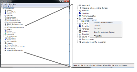

    Select "Other Devices", then right-click on "ETC Smartfade" and choose "Update Driver Software..."
    Device Combined

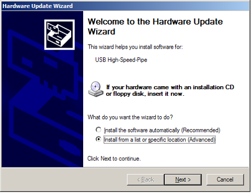

    This will bring up the "Hardware Update Wizard".  A dialogue box will open, asking whether to connect to the internet to search for a driver or browse for driver software:
    Select "Install from a list or specific location (Advanced) and click [Next].

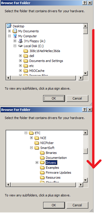

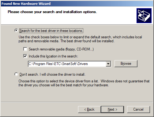

    Select "Search for the best driver...".  Select "Include this location in the search:", then press the [Browse] button.  The drivers should be located in C:\Program Files\ETC\SmartSoft\Drivers.
    Browse For Folder
    Once you have the drivers directory selected you will be able to click the [OK] button which will return you to the previous screen with the directory location entered into the text field as described above. Click on the [Next] button and it will bring you to a screen similar to this :

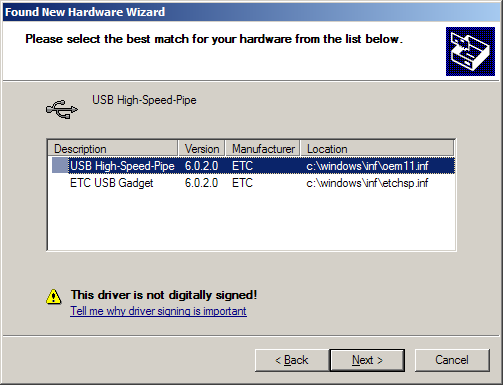

    XP Select Driver

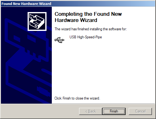

    Select USB High-Speed-Pipe and click [Next].  This will load the correct drivers.
    Driver completed

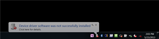

    When the install is complete you can connect the console to your computer. The computer will take a few moments as it recognizes that it has a new device attached to the USB port. It may then give a pop-up message :
    Driver Not Installed Windows 7

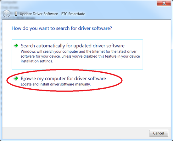

    This will bring up a Wizard. A dialogue box will open, asking whether to connect to the internet to search for a driver or browse for driver software:  Select "Browse my computer for driver software".  In the following window, click the [Browse] button, and go to C:\Program Files\ETC\SmartSoft\Drivers.  Be sure that "Include subfolders" is checked.  Then click [Next].
