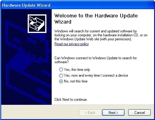

    1. Connect Master Playback Wing to computer via USB cable; wait for following dialog box to appear. Select No, not this time, and then select Next.

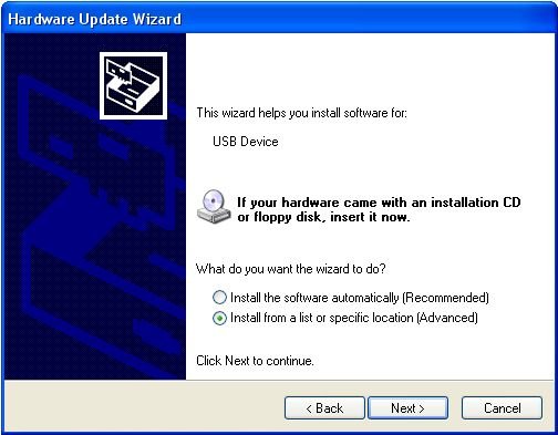

    2.  Select Install from a list or specific location (Advanced) and then select Next.

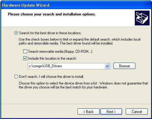

    3.  Select Search for the best driver in these locations. and Include this location in the search. Open the Browse option and navigate to the folder on your computer where \congo\USB_Drivers is located. Once the file directory for \USB_Drivers is selected, press Next.

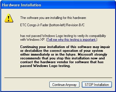

    4.  The following dialog will come up. Select Continue Anyway.
     Hardware4

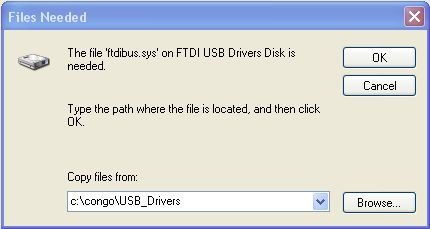

    5.  Again navigate to the \Congo\USB_Drivers\ directory and select OK.
     Files Needed

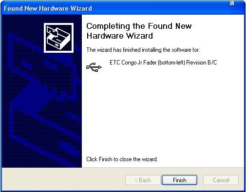

    6.  Select Finish.
     Finish

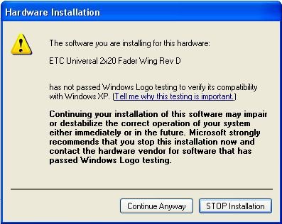

     Universal Fader 4

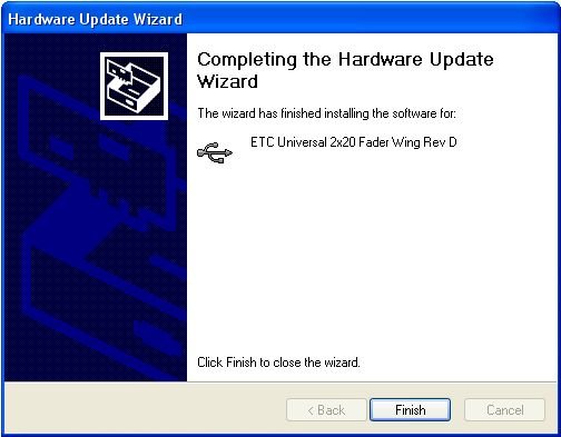

    6.  Select Finish.
     Universal Fader 6
    The Universal Fader Wing should be ready to use now with Congo Client/OLE software.
