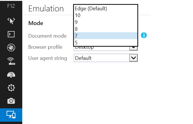

    Microsoft has incorporated Developer Tools into Internet Explorer 11 which can be set up to do just that by following the instructions below.
    Step 1: Press F12 to open the developer tools ribbon.
    Step 2: Go to the Emulation screen, represented by this logo:
    Step 3: On the Emulation tab, change the Document Mode to 7 (this is the IE version are emulating):
    Step 4: Refresh the Sensor+ Connect login page.
    Step 5: Log in.
