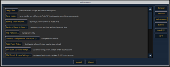

    Step 4)     Select {Maintenance} This is on the RIGHT hand side of the screen.
    Ion Maintenance
    Step 5)     Select {Save Logs} This is on the LEFT hand side of the screen.
    Step 6)    Follow the given prompts. Unless instructed to go to Advanced mode, choose {Next}.  When prompted, enter a short description of the issue and the date/time and press {Next}. Finally, choose the USB drive that you'd like to save the files to. Press {Next}, and once complete, press {Exit}.
