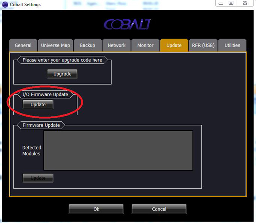

    To install the drivers, exit to the System Settings, click on the Update Tab and select the I/O Firmware Update Button.
    Update Tab

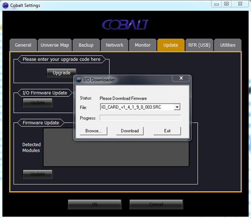

    A popup window will appear; from the File pull down menu, select IO_CARD_V1_4_1_9_0_003.SRC then click the Download button which will complete the firmware installation.
    Io Card
