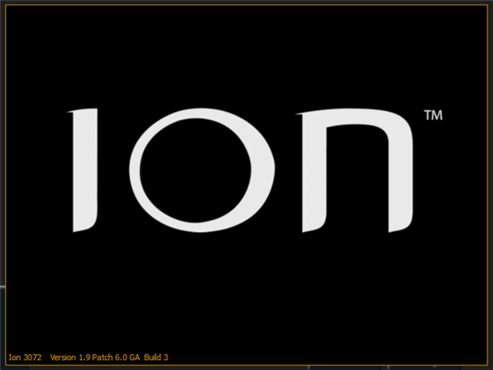

    1. While booting, the console splash screen will display the version information

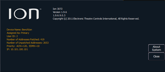

    2. When fully launched into the software, clear the command line and press [About]. The version number will be displayed to the right of the logo.
