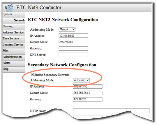

    Connect to the Internet
    Typically an Internet-connected network will have an Address (DHCP) server, so you will need to configure Conductor's secondary network port for Automatic addressing:
    Net3 Conductor screen shot 1
    When Conductor receives a valid IP address from the Internet connected network, it will show in the IP Address field.

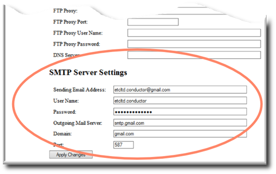

    1. Configure Email Server
    Conductor version 2.0.0 or lower only supports sending email alerts. You will need an email server to send the emails. Conductor does not send email directly, rather it connects to an email server such as your internal organization email server or Google's GMail server, and tells that server to send email. To configure Conductor you will need details of your email server, which could be inside your organization (such as a Microsoft Exchange server), or a third party service such as GMail. If you are using a server within your organization, your network administrator should be able to provide these details; if using an external provider, this should be available from the information page on how to set up email clients.
    You will need to know:
    • The email address (this is the email address the email will say on the from line, for example conductor@gmail.com)
    • The user name (used to log into the server - often the same as the first part of the email address before the @ symbol)
    • The password to be used to log into the server (if an internal server doesn't require a password, leave this blank)
    • The name of the outgoing mail server (also called an SMTP server, for example smtp.gmail.com)
    • The domain of the mail server (usually just the last part of the address, gmail.com for example)
    • The port of the mail server (usually 25 unless the provider says differently)
    Enter this information in the SMTP Server Settings section of the Network Configuration page
    Net3 Conductor screen shot 2
