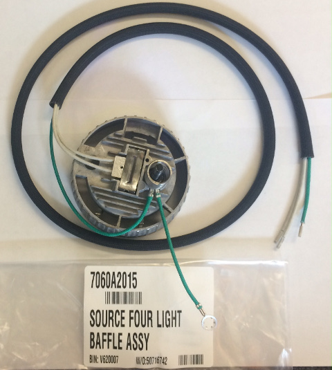

    If you have an older (Pre-1997) Source Four fixture and purchase a new lamp socket assembly (ETC Part# 7060B7019 - S4 UL Socket Assy) for the unit, the new sockets may not fit. You will need to purchase a S4 Light Baffle Retrofit Kit (7060A2015). That kit includes the new baffle, a new socket, and several other parts as one complete unit:
    7060A2015 Light Baffle Assembly
