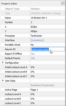

- Select a station from the device list in the Network view, or select a station from the Browser or Folders. The selected station properties display in the Property Editor.
- Locate the Neuron id from the product label and enter the data into the "Neuron ID" field of the property editor. The id will store into the project configuration for that station permanently and the Lon Address will be assigned and stored to the configuration.
Note: If you are programming a system in Live Edit Mode, the processor will also update and store with the Neuron id of the configured station. If the station is also online, it will bind to the processor automatically. Alternatively, when the project is uploaded to the online processors, the configured stations that are online will bind to the associated processor automatically.

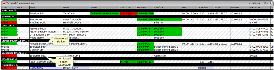

LightDesigner features the ability to associate a detected Neuron id to a configured station within the device list. The station that is in the configuration (expected) will display as "Offline" and display "Invalid" for the Neuron id. A Neuron id detected on the station bus, that has no station association, will not have a status and instead displays "Unbound" in the Lon Address column.

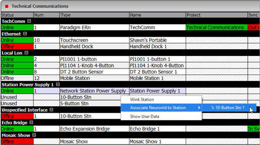

To associate the discovered station to the configured station, right click on the detected station and select "Associate NeuronId to Station..." from the context menu, and then select the compatible and available station from the available list.
When the station is selected for binding, the Neuron id is associated to that configured station. If you are not working in Live Edit Mode, you will notice the configured station displays the new Neuron id in the device list, but still has an offline status. You must enter Live Edit Mode and synchronize the configuration with the processors. When the system is synchronized, you will notice that the configured station displays the correct Neuron id, has been assigned a Lon Address, and is now online. The previously discovered station node is no longer displayed in the device list.
