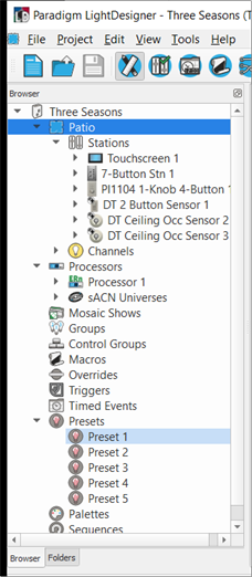

Folders is provided as an alternative user customizable Browser. Folders, by default, is found in a tab behind the Browser.
You may relocate the Folders tab by docking to another location in the application window pane, reference Application Window Panes.
Using Folders
A Folder is a container for user configurable Browser tree objects including; channels, stations, walls, processors, groups, control groups, Macros, overrides, triggers, timed events, presets, palettes, sequences and even spaces.
When the Folders pane is moved into a floating position or docked into a different location of the application display, you can easily drag objects from the Browser into a folder within the Folders pane.

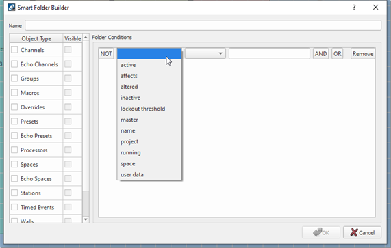

Smart Folder Builder
The Smart Folder Builder is a dialog that displays to create Smart Folders and Child Smart Folders. Begin creation of either by providing a unique name in the field provided.
Folder Conditions are specific filter criteria that is applied to the selected object type(s) in the Smart Folder Builder. Selecting the [NOT] button for a folder condition provides additional filtering by exclusion.
- the active condition: filters the status of the selected objects based on their active status
- the affects condition filters presets based on whether they affect any channels within a selected space or project
- the altered condition filters the status of selected object based on its altered status
- the inactive condition filters the status of the selected objects based on their inactive status.
- the lockout threshold condition filters stations based on their lockout level.
- the master condition filters the active master value for selected group and/or space objects
- the name condition filters the name of the selected object, using text matching
- the project condition filters the selected objects by inclusion within a space.
- the running condition filters the macros based on their status.
- the space condition filters the selected objects by inclusion within a Space.
- the user data condition allows filtering of objects based on the user data tag and the meta-data value.

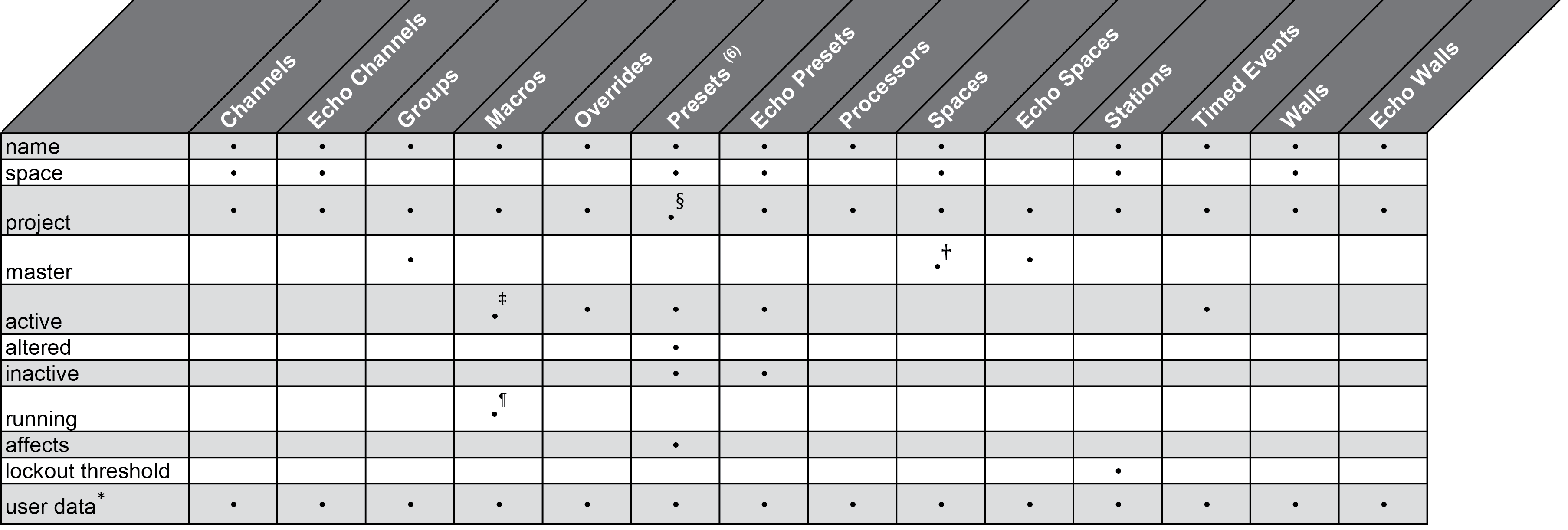

Not all "Folder Conditions" are applicable to all Object Types. The table below identifies which conditions are applicable to each other.
