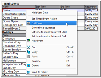

Timed Events
Lists all timed events in alphabetical order. From this report, you can select the event, and view or set specific timed event properties using the Property Editor, right-click on the event and select actions from the provided context menu.
Timed Events, Report View Edit Timed Event

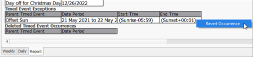

Timed Event Exceptions
Lists all created Timed Event Recurrence Exceptions. From this report, right-click on the exception and select "Revert Occurrence" from the context menu to cancel the exception.
Timed Events Report View, Revert Occurrence
Deleted Timed Event Occurrences
Lists all timed event occurrences that have been deleted. From this report, right-click on the deleted occurrence and select "Revert Occurrence" from the context menu to cancel the exception.
Timed Events Report View, Revert Occurrence Deletion
