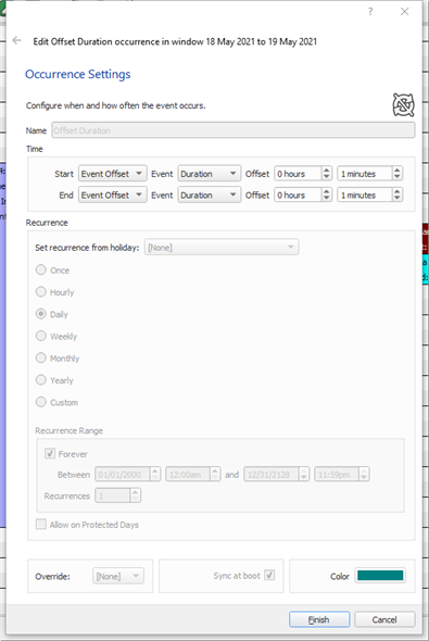

- Selecting "Only this occurrence" displays the Occurrence Settings dialog for edit of the Time fields for both Start and End. Altering these settings will affect when this event should occur on the selected occurrence without affecting the other event properties, such as configured actions.

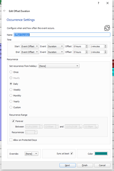

- Selecting "All occurrences" displays the Occurrence Settings dialog for edit of all settings in the event. Altering these settings will affect the event settings for the event in all occurrences.
