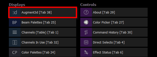

Eos Family devices that meet the Hardware and Software Requirements can run Augment3d natively via Augment3d [Tab 38].

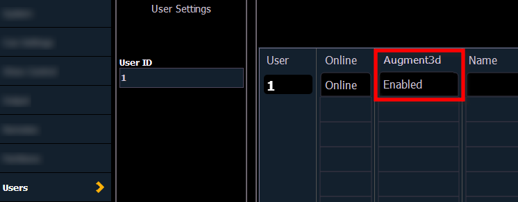

  2. On the console, enable Augment3d for your user number. In the CIA, navigate to Setup > System > Users.

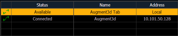

  5. Choose the correct tether device on the console (see Setup > Device > Augment3d).
