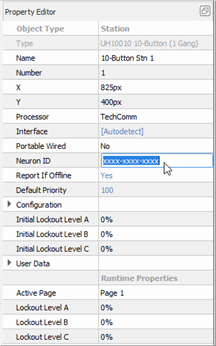

LightDesigner can automatically bind an installed control station that is discovered on the Paradigm network to the Paradigm Processor if it is also found (expected) in the configuration. If the LightDesigner session is connected and in Live Edit Mode while binding, the 4-button station's Neuron id and a Lon Address are stored in the configuration.
Note: Automatic station binding does not work in this manner when more than one 4-button station is expected to be connected in the configuration. In these instances, station binding is best accomplished either at the Paradigm Processor user interface (Arch Setup > Station Connections menu), by manually entering the Neuron id into the station properties of the Network view, or by associating the Neuron id to a configured and discovered station.

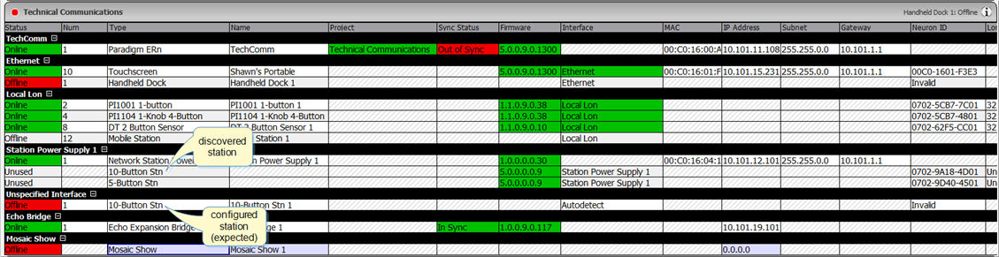

LightDesigner features the ability to associate a detected Neuron id to a configured station within the device list. The station that is in the configuration (expected) will display as "Offline" and display "Invalid" for the Neuron id. A Neuron id detected on the station bus, that has no station association, will not have a status and instead displays "Unbound" in the Lon Address column.

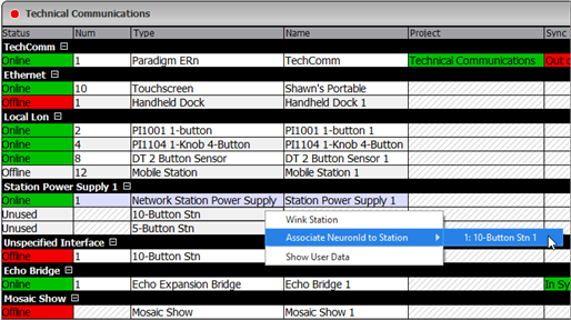

To associate the discovered station to the configured station, right click on the detected station and select "Associate NeuronId to Station..." from the context menu, and then select the compatible and available station from the available list.
When the station is selected for binding, the Neuron id is associated to that configured station. If you are not working in Live Edit Mode, you will notice the configured station displays the new Neuron id in the device list, but still has an offline status. You must enter Live Edit Mode and synchronize the configuration with the processors. When the system is synchronized, you will notice that the configured station displays the correct Neuron id, has been assigned a Lon Address, and is now Online. The previously discovered station node is no longer displayed in the device list.
