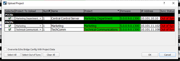

When the LightDesigner configuration file differs from the configuration on connected Paradigm processor(s) or Paradigm Central Control Server, the synchronization status will display as "Out of Sync" in the device list. Upload the current LightDesigner configuration to the connected Paradigm processor(s) using the [Upload Project] button in the Network view.
Note: Alternatively, from any view within LightDesigner Software, pressing (Ctrl)+ (U) switches to the Network view and displays the "Upload Project" dialog.
Note: Selecting this checkbox overwrites the Echo Expansion Bridge configuration data only for bridges that are associated with the selected Paradigm processor(s).
Note: A dialog will display for any errors that require your attention prior to the upload. Follow the dialog to proceed with or cancel the upload process.
