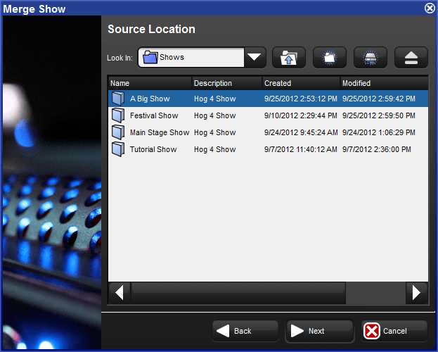

Press Merge to be guided through the merge process. The Merge Show window will open; see Figure 4.4, “The Source Location page of the Merge Show window”.
Choose a source show file. Note that if you have chosen a backup (.bck or .shw) file, it may take a few extra moments for the console to uncompress the show file and read its contents.
Once you have chosen a source show, you will be offered several options for data that can be merged: Fixture Types, Fixtures, and Programming (user kinds, groups, palettes, plots, cuelists, scenes, pages, macros, views, and reports).

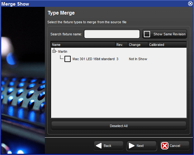

Once you have selected a source show, Hog 4 OS compares the fixture types contained within each show file and creates a list of fixture types which have changed; see Figure 4.5, “The Type Merge page of the Merge Show window”.
An expanding tree shows the fixture types that do not match exactly and will explain what their differences are:
Newer: the fixture type in the source show is a newer revision.
Older: the type in the source show is an older revision.
Not In Show: the type is in the source show but not the current show.
If you want to see all fixture types in the source show file even if they match the fixture types destination show, press Show Same Revision.
Select the fixture types to merge by clicking on their check boxes. The Deselect All button allows you to clear the current selection and start again. Press Next to continue.

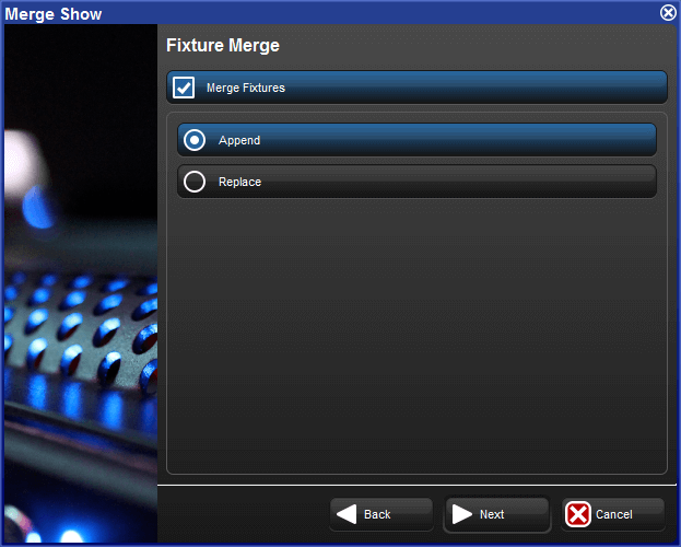

After choosing to merge fixture types, you can merge the fixtures used in the two shows; see Figure 4.6, “The Fixture Merge page of the Merge Show window”. If you choose not to merge fixtures, you will not be able to merge any programming other than macros, views, and reports.
There are two options for merging fixtures:
Append: appending fixtures will add a copy of all of the fixtures from the source show into the current show. Any programming that is merged from the source show will use the appended fixtures and all programming in the current show will continue to use the same fixtures as before.
Replace: replacing fixtures will match fixtures from the source show with fixtures in the current show using a combination of the fixture type and user number. If a match is made, the fixture in the current show is replaced with the one in the source show and all programming in the source and current show that used that fixture will use the merged fixture. If no match is made, the source fixture is appended to the current show as above.
![]() | Important |
If you merge fixtures and then merge programming, because both the source show and the current show are using the same fixture, any programming from the source show using that fixture will overwrite the programming in the current show. |

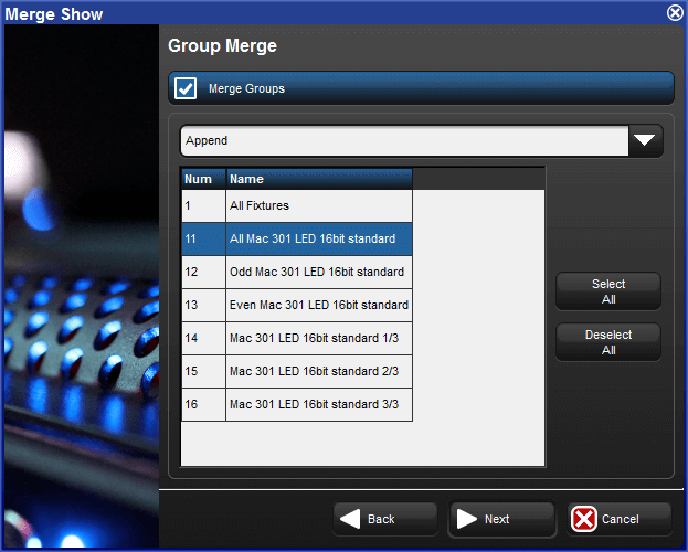

After merging fixtures, you can merge the programming (user kinds, groups, palettes, plots, cuelists, scenes, pages, macros, views, and reports) from the source show; see Figure 4.7, “The Group Merge page of the Merge Show window”.
When merging programming the following merge methods are available from the drop down menu in the Merge field:
Append: appends all of the programming from the source show to the current show.
Append Different: appends programming from the source show if programming of the same type and name cannot be found in the current show.
Merge By Name: merges source show programming into the current show when programming objects of the same type and name cannot be found in the current show; if programming objects of the same type and name already exists in the current show then the source show programming is not merged in.
Merge By Number: merges source show programming into the current show when programming objects of the same type and number cannot be found in the current show; if programming objects of the same type and number already exists in the current show then the source show programming is not merged in.
Replace: replaces current show programming with source show programming when programming object numbers match; appends source show programming objects that do match current show programming objects.
After selecting the merge method, you can select which programming objects to merge by clicking on each item displayed in the window. Items highlighted in blue are selected for merging.
