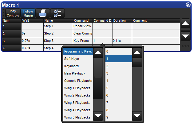

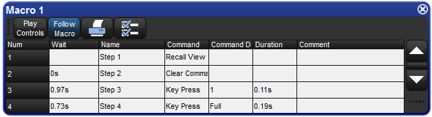

You can edit the contents of a Macro in an editor window. For example, to open Macro 1 for editing:
Open + Macro: opens the Macro Directory.
Open + [Macro 1]: opens the Macro editor for Macro 1.
Alternatively, using the command line: Open Macro 1
The Keystroke Macro window has six columns that define each step of the macro.
Wait: The Wait time is the time between the triggering of the previous step and the next step to be triggered.
Name: The name of the step.
Command: Type of command used in this step.
Command Data: The data that is applied to the selected command. The type of command selected will determine the type of available command data.
Duration: The amount of time for the command data to be applied. This information is useful for encoder movements and flash key presses.
Comment: A notes field.
Each of the above fields can be edited by selecting the appropriate cell and pressing Set. Command and Command Data fields will display available selections. See Figure 24.2, “Command Data Selection”
