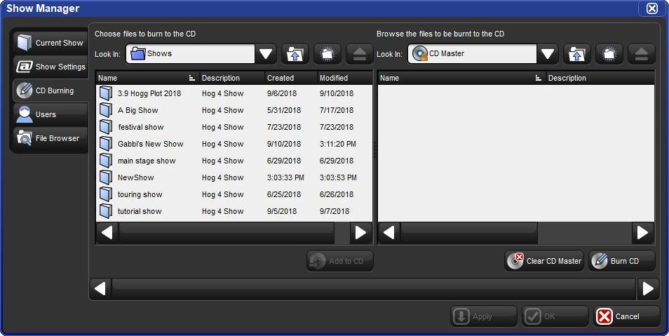

To burn files onto a recordable CD:
Setup → Shows → CD Burning : see Figure 2.12, “The CD Burning pane of the Show Manager window”.
Select a file to be copied in the left-hand list, and click the Add to CD button to move it to the right-hand list. You may be asked to archive the file before adding it to the list; click OK to agree to this.
Repeat for all the files you want to copy to the CD.
Insert a recordable CD into the CD drive, located under the console's front wrist rest.
Press the Burn button, and then the Start Burn button in the CD Burning window. The window will show the progress of the writing operation.
![]() | Tip |
You can use drag and drop to move files to the CD Master list. Note that files will always be copied, not moved. |
