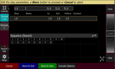

Sequence recording is a mode which takes over the screen. The recording mode is shown by a red surround to the screen.
While in the recording mode you may visit other screens to set parameters and effects. While in those screens, a red watermark will be displayed showing what step you are editing.
To return to the main recording screen press Record / Edit again. You may store the step you have made and exit immediately with Store & Exit or you may store the step and remain inside sequence recording to record further steps with Store & New. Press Cancel to leave the recording screen without saving anything.
