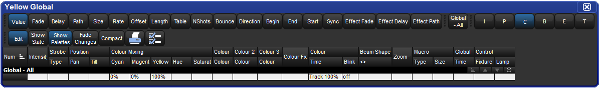

Figure 8.3. A Palette with Global Parameter Values
Screenshot fragment showing "All types" data

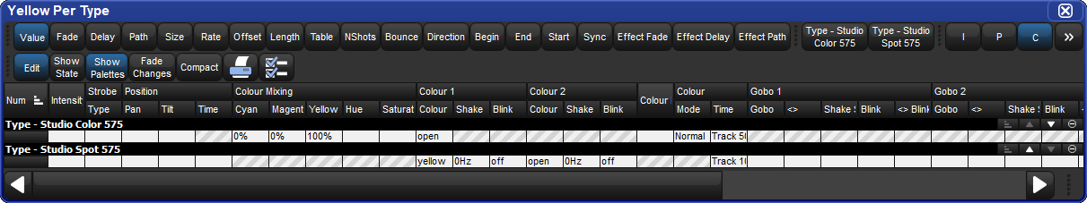

Figure 8.4. A Palette with Per Fixture Type Values
Screenshot fragment showing "All Studio Color 575" data

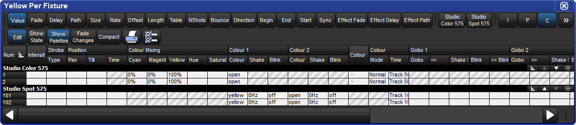

Figure 8.5. A Palette with Per Fixture Values
Screenshot fragment showing "Studio Color 575" data

Forcing a palette to be Per Fixture Type can be useful if you want a palette that contains programming for more than one type of fixture, but that you can apply to any fixture of a type included in the palette. For example, you want to create a ‘red’ palette that can be applied to both Studio Colors and Studio Spots. If you select the first Studio Spot and make red then select the first Studio Color and make red (with different parameter values) and record this as palette, it will by default be by fixture and work only for those two fixtures. However if you select Per Fixture Type when recording, then the palette will work for all Studio Spots and all Studio Colors, assigning them the same values as was used to create the palette.

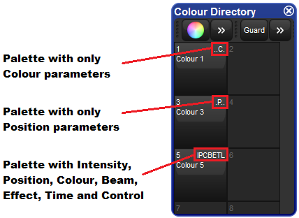

The Palette Directory will display which fixed kinds are included in each palette, indicated by I for intensity, P for position, C for colour, B for beam, E for effect, T for time and L for control; see Figure 8.6, “Example of Palettes containing different parameter types”.
Figure 8.6. Example of Palettes containing different parameter types
