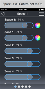

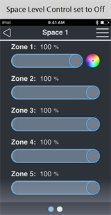

Space Level Control
If the Space Level Control setting is switched On in General Configuration, the top control on the Zone Control screen will be labeled with the name of the Space being controlled. This top slider controls the level of all Zones in the Space. If you set all Zones in the Space using the Space Level Control slider and then change the level of individual Zones with their sliders, the Space Level Control slider will update to the highest level in the Space. The top color picker controls the color of all Zones in the Space. The Space Level Control color picker is only available if at least one Zone in the Space has the color picker set to [Show] in Space Configuration under Zone Info.
