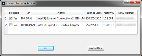

When ETC Concert is launched for the first time, or if a network interface on the host computer changed since the last time the configuration in Concert was opened, the Concert Network Access dialog displays.
Network details are shown for each identified network interface including the IP Address, Name, Subnet Mask, Gateway, and MAC Address.
Choose the preferred network interface for the lighting system by selecting the related check box. This selection persists each time Concert is closed and reopened until a network interface changes or the Network Access preference is changed.
Note: A network interface that is not physically connected or has an IP Address of 0.0.0.0 will show as unavailable in the selection column. This network cannot be selected for use until it has been configured.
If you are working offline, without any network connection, click the Work Offline button to start Concert in offline mode.
