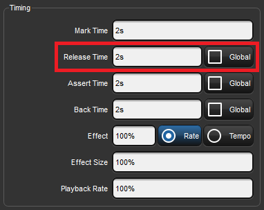

17.4.1 Release Time
When you release a cuelist and fixture parameters go to their default values, they do so over the release time, and this change may be visible if you have fixtures that are visibly live on stage (i.e. with intensities above zero). To assign the cuelist's release time:
  1. Open + Choose : open the Cuelist window for the cuelist on the selected master.
  2. Options → Cuelist : open the Options window and select the Cuelist pane.
  3. Alternatively, press Pig + Choose to open the Options window for the selected master.
  4. Select the Release Time cell:
Playback Option Cuelist Release Time

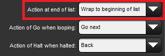

17.4.2 Auto Release
You can use auto release options to send fixture parameters to their default values at the end of a show, or to relinquish control of parameters for use by other cuelists when a cuelist is no-longer needed.
There are two Auto Release options for cuelists:
You can assign auto release options in the Playback Options window of each cuelist:
  1. Open + Choose → Options → Cuelist
  2. Select the desired release option from the Action at End of List menu:
Playback Option Cuelist Action End List

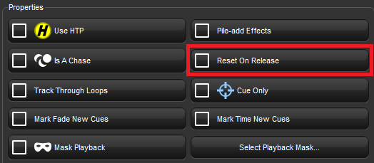

17.4.3 Resetting Cuelists on Release
You can assign a cuelist to reset when released so it will proceed from the first cue when Go is pressed again. You can assign Reset on Release in the Playback Options window of each cuelist:
  2. Select Reset on Release:
Playback Option Cuelist Reset Release
