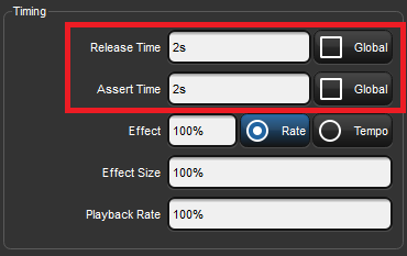

The Assert Time
When you assert a cuelist, the parameters that have been asserted change to their new values over the assert time. The default is 2 seconds, but you can assign your preferred assert time for each cuelist:
  1. Open + Choose → Options → Cuelist
  2. Select the Assert Time cell:
  3. Playback Opt Cuelist Assert Time
  4. Set 5, Enter : change the assert time to 5 seconds.
  5. Alternatively, you can assign the Assert Time for all new cuelists in the Cuelist pane of the User Preferences window:
Tip: If you have assigned an assert time to a cuelist, and you want to revert to the default assert time, press the Default button adjacent to the Assert Time cell.

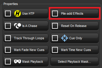

17.6.2 Multiple Cuelists with Effects
If a cuelist contains parameters that are running an effect, when another cuelist or scene changes the underlying values of those parameters the effect continues to run. Use Pile-Add FX to allow the second cuelist or scene to override the effect as well as the underlying values.
For example, to allow the cuelist on Master 10 override effects running on other masters:
  1. Open + Choose : open the Cuelist window for Master 10.
  2. Options : open the cuelist's Playback Options window.
  3. Select the Cuelist pane and select Pile-Add FX:
Playback Opt Cuelist Pile Add Fx

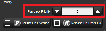

17.6.3 Changing a Cuelist's Priority
Under the LTP rule, the most recent action determines the value of a fixture parameter; see Latest Take Precedence (LTP). However, you can override this precedence by assigning cuelists different priorities, so that cuelists with a higher priority take precedence over those with a lower one. If their priority is equal, then the LTP rule is used to determine which cuelist will take precedence and determine the parameter's value.
A cuelist's default priority is 0, and you can assign the priority value in increments of 10. For example, if the priority of the cuelist attached to Master 5 is at default (0) and the priority of that on Master 4 is 50, then a Go triggered on Master 5 will not override common parameters currently active on Master 4. Conversely, you can apply a minus priority so if the cuelist on Master 3 has a priority of -50, common parameters on Master 5 will override those on Master 3.
To change a cuelist's priority:
  2. Select the Playback Priority cell:
  3. Playback Opt Cuelist Priority
  4. Set 50, Enter : change the priority to 50.
Alternatively, you can assign the Playback Priority for all new cuelists in the Cuelist pane of the User Preferences window:
In the event that two or more cuelists share the same priority level, normal LTP rules are applied.

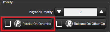

Persist on Override
Hog 4 OS automatically releases cuelists when all of their parameter contents have been overridden by other cuelists. However, sometimes it is useful to return to a cuelists's look when overriding cuelists have been released; in this case you can use Persist on Override. When this option is activated, the overridden cuelist will not automatically release and will remain active when the overriding cuelist is later released.
To turn Persist on Override on for a cuelist:
  2. Select Persist on Override:
Playback Opt Cuelist Persist Override
Alternatively, you can assign Persist on Override for all new cuelists in the Cuelist pane of the User Preferences window:
