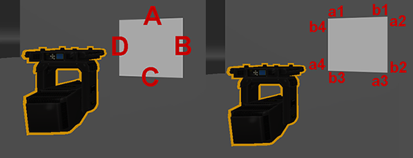

Shutters
If you have a fixture with shutters, they must be configured in the Fixture Editor to display accurately in Augment3d.
  1. First ensure that the fixture is hung base up and that pan and tilt are moving the fixture in the correct directions. If not, correct these before continuing.
  2. Adjust tilt to +90° or until the fixture is pointing at a wall.
  3. Set the frame assembly angle near the mid-range so that the shutters form a square.
Standard shutter controls are now normalized relative to the square so that A controls the top edge, with controls B, C, and D continuing clockwise in that order.
Pushrod-style shutter parameters are normalized so that frame a1 corresponds to the counterclockwise side of the top edge and b1 to the clockwise side, with frames a2, b2, a3, b3, a4, and b4 continuing clockwise in that order.
