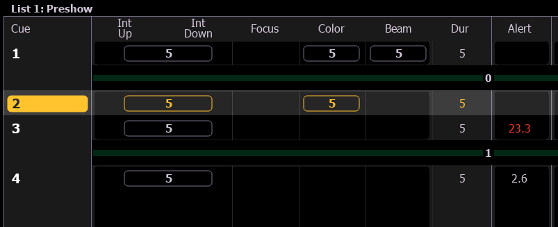

Alerts in the Playback Status Display
The Alert column can be enabled in the PSD via the Playback Status Display Tab Configuration menu.
When alerts are being learned, a count-up timer appears in red in the Alert column after each manual [Go] command. After the next [Go], the time is stored and the process repeats.
Once alerts have been learned, after a manual [Go], the recorded time in the Alert column will begin counting down.
When the countdown is below 5 seconds, the time will change to gold, and the alert advisory sound will play.
When the countdown reaches 0, the time will change to green and display until the next manual [Go].
