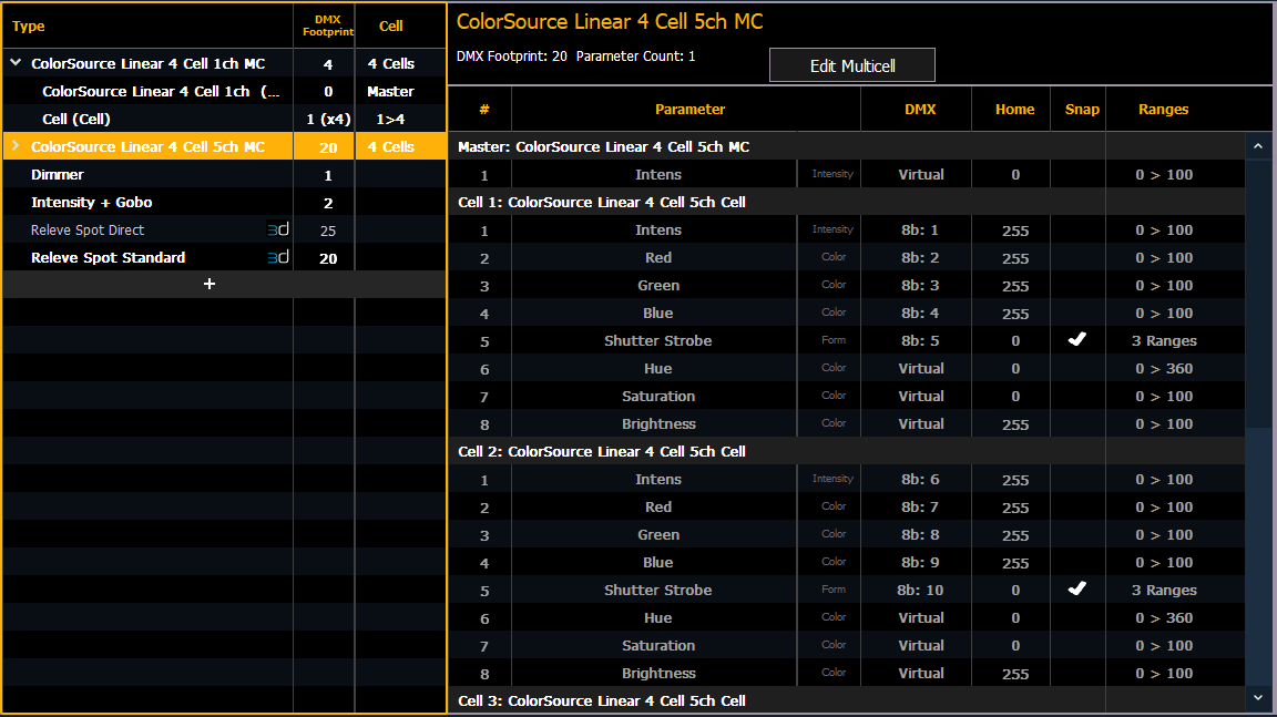

In the Fixture Editor, you can view and edit the personality for your multicell fixture. For creating a new multicell fixture, see Creating Multicell Fixtures.
On the left of the fixture editor, you can see the fixture name, overall DMX footprint and number of cells. Click on the caret to see the DMX footprint for the master and the cells. The cells will be grouped with their profiles.
On the right, you can see the full personality of the selected multicell fixture. If you have the whole fixture selected, you will be able to see all of the parameters for each cell and the master but changes cannot be made here.
